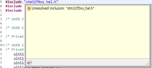

In my #include section of main.c file.
Red error line indicates like, Embarrassed ( dont tell me contact stm32, its a s/w question)

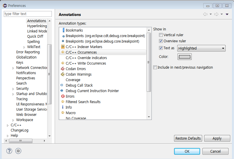

At the same time the system says to do indexer marker, Embarrassed

Kindly suggest me what to do for this issue?

"unresolved inclusion" means the file can't be found.
This means the directory containing it hasn't been specified to CDT or it has been misspelled.
If spelled correctly, normally you would specify the path with Project --> Properties --> C/C++ General --> Preprocessor Include Paths, Macros etc. on the Entries tab as a user entry.
http://help.eclipse.org/neon/index.jsp?topic=%2Forg.eclipse.cdt.doc.user%2Freference%2Fcdt_u_prop_general_sd_entries.htm
Odd. How is it telling you this?
