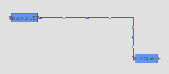

I'm working on the project where we have blocks, ports as their children and connections which should connect those ports (I will attach the picture of two blocks connected with one connection, so you can have visual representation). I have been looking in org.eclipse.gef4.mvc.examples.logo how it's done and have been using lot of code from there. Still, I have few problems:
