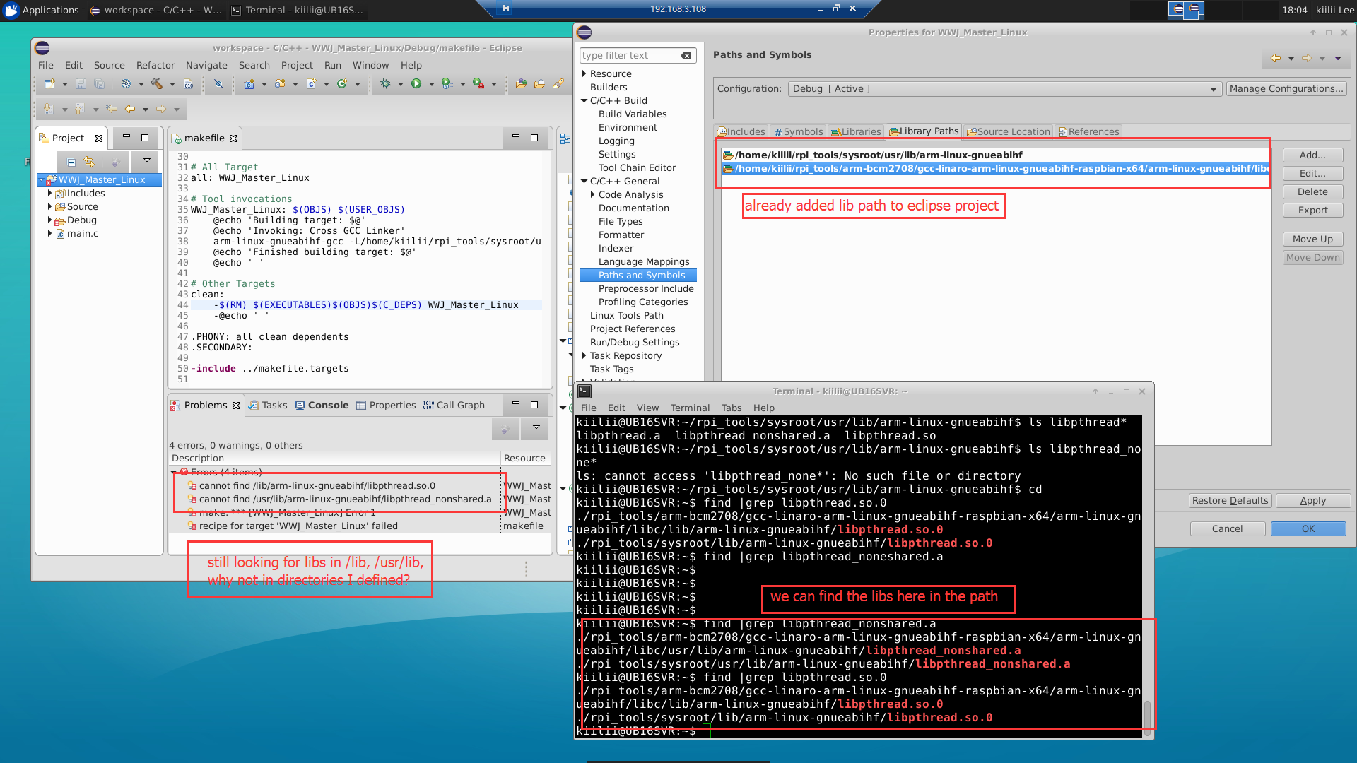

Hi guys,
I'm using eclipse neon for my project under ubuntu server 16.04 with xfce. I installed libxml on a raspberry-pi3, and then copied the whole lib/include directory from pi3 to ubuntu /home/xxx/rpi_tools/sysroot. Then I included paths in eclipse project library path, but eclipse still looks for libs in /lib and /usr/lib.
Please check the pictures below for more details.

It's unusual for the loader to print a complete path for a missing library.
How would it know which path to prepend and how would it know the so library ended with so.0?
It's as if the path and name (e.g., /lib/arm-linux.../libpthread.so.0) were given on the link command line.
I would expect the message to be "No such file or directory" but it may be version/flavor dependent.
Attach the complete build log to your next post or at least the link portion from the log.
