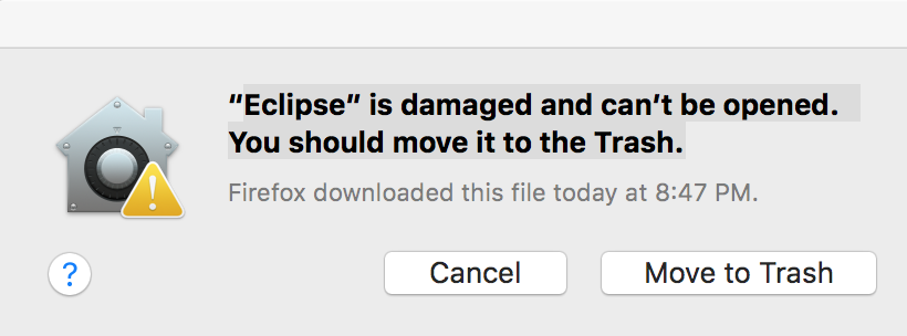

Home » Newcomers » Newcomers » Couldn't download eclipse luna in MacOS Sierra(I got an error "Eclipse" is damaged and can't be opened. You should move it to the Trash." Ask to move to trash)
icon11.gif  Couldn't download eclipse luna in MacOS Sierra [message #1749641] Thu, 08 December 2016 21:20 Go to next message
I need to use ggts for my project.
Can someone help me.
Re: Couldn't download eclipse luna in MacOS Sierra [message #1749707 is a reply to message #1749641] Fri, 09 December 2016 16:28 Go to previous messageGo to next message
What is the file name (and link) that you downloaded?
icon11.gif  Re: Couldn't download eclipse luna in MacOS Sierra [message #1749712 is a reply to message #1749707] Fri, 09 December 2016 17:48 Go to previous messageGo to next message
This is the link:
https://eclipse.org/downloads/packages/eclipse-ide-java-developers/lunasr2
I downloaded Mac OS coca 64-bit that fits by computer.
File:eclipse-java-luna-SR2-macosx-cocoa-x86_64.tar.gz

Re: Couldn't download eclipse luna in MacOS Sierra [message #1749898 is a reply to message #1749712] Tue, 13 December 2016 10:44 Go to previous messageGo to next message
How did you unpack that file's contents?
Re: Couldn't download eclipse luna in MacOS Sierra [message #1749993 is a reply to message #1749804] Wed, 14 December 2016 19:56 Go to previous messageGo to next message
Yes I know it is behind releases. I am fine with the eclipse that supports https://spring.io/tools/ggts-the groovy/grails tool suite. I know eclipse luna support ggts. So how do we unpack the file contents.
Thanks for the response.
Re: Couldn't download eclipse luna in MacOS Sierra [message #1749994 is a reply to message #1749804] Wed, 14 December 2016 20:00 Go to previous messageGo to next message
I am having the same issue. This the package that is available on the eclipse website. How do we get the newer version that you have mentioned?
Re: Couldn't download eclipse luna in MacOS Sierra [message #1750059 is a reply to message #1749994] Thu, 15 December 2016 09:31 Go to previous message
On the GGTS web page (https://spring.io/tools/ggts) there is a link to download it directly - have you tried that?
If you want to use the Eclipse installer, go tohttps://www.eclipse.org/downloads/ and use the big, orange Download button. Run that installer, switch it to Advanced mode (via menu button in the upper-right corner), then you can select the Luna version to install.
