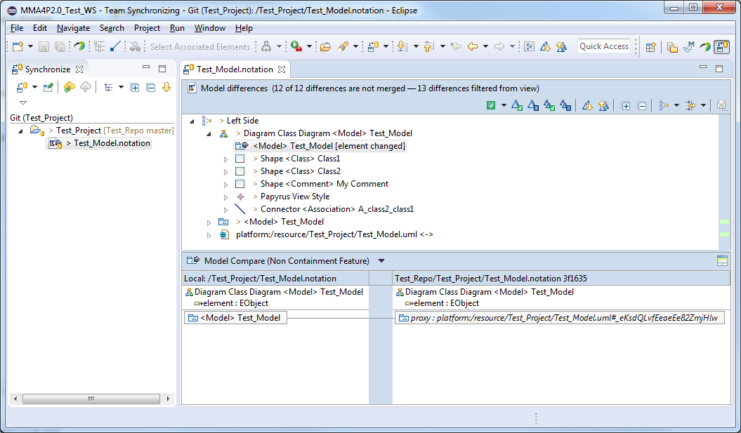

When I try to compare a workspace version of a simple Papyrus model with an earlier version stored in a local git-repo using "Compare With->Commit..." from the context menu the resulting differences in the comparison editor indicates a lot of differences even if there are only one element that have been moved slightly in a diagram.
The right side of the comparison editor indicates that something have not been resolved correctly as elements are presented staring with "Proxy:Platform resource..." instead of the actual name of the element. See attached screenshot

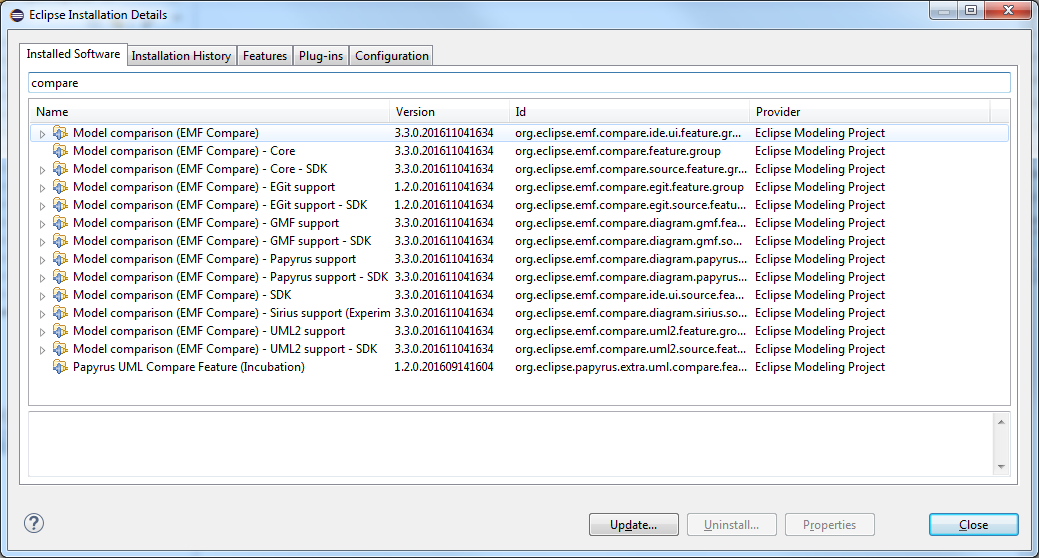

I am running Papyrus 2.0.1 on Neon.1 on Windows 64 and have installed EMF Compare 3.3 with support for UML2, GMF and Papyrus, see attached screenshot.
I have selected the "Recursive Model Merge Strategy" and also "Pre-merge models when a real conflict is detected" in the preferences.
Have I missed something in the installation around EMF Compare/Git support or are there any more preference settings to tune?

Hi Thomas,
it looks like the Test_Model.uml could not be resolved on the right-hand side, for some reason. It does still exist in the commit you compare your workspace to, right? Was it maybe renamed or moved?
Do you use the integration builds from collaborative-modeling.org? The version numbers indicate that you are not, but I didn't double-check.

The EMF Compare plugins was installed from the official 3.3 update site (http://download.eclipse.org/modeling/emf/compare/updates/releases/3.3/) all parts was selected.
I thought that was the recommended version to use.

As it turns out, the issue you are having in your comparison (as shown in your screenshot), is because the comparison has been started from the project and not from the model file. If the comparison is started from the model, the comparison works well. I could reproduce this issue and took the liberty to create a bug report (bug 508855). After looking into this bug, I found the reason for it and sketched a solution, which I'll push for review and testing soon. I'll have to check if my solution has any side-effects first. Feel free to cc yourself in bug 508855, if you want to be notified on the progress.
