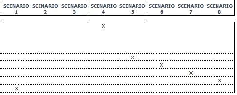

This report is created on Users application and has custom table which points out different scenario of user access like Scenario 1 , Scenario 2, Scenario 3, Scenario 4, etc. All these scenario output should come in a row rather than multiple rows.
Image 1 is something that's coming as output , there are 8 rows appearing however the expectation is only 1 , this output is only for 1 user.

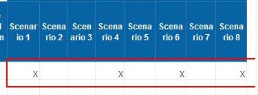

however Image 2 is something that is expected
index.php/fa/27775/0/
I tried doing cross tab however it's displaying the count in Scenario field as 6 or only those fields that has X and not something like Image 2 .
Any thoughts!!

You are showing far too little information.
Your report presumably is grouping by something - user, access level, whatever. You appear to have scenario appearing as a field in the detail level.
What you need to do is aggregate so that you can collapse all of the scenarios into a single row. therefore, in your group footer, you would show max(scenario_1_value), max(scenario_2_value) etcetera, which would be the X or null values.
That's as much detail as we can give based on the information you presented.

(1) Note your formula for S1 appears to be incorrect - it plants an X if scenario = SCENARIO2, probably should be SCENARIO1.
(2) Your data row from the cube is atomic at the user/group/scenario level. But you want your report to collapse all scenarios onto the same line.
Therefore you need to create a group in your TABLE on userid (assuming that a userid can be associated with only one groupname). Move the userid through groupname fields down into the group footer. Then, in the group footer, add Aggregation entries (using the MAX function) for the s1 through s8 elements.
