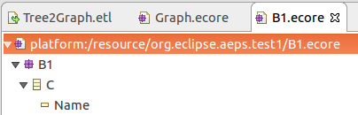

Q1. They are just two different ways of representation, one of which can be converted to the other one automatically.
Q2. B1 is not a kind of EClass, it is a package. I can guess that ETL rules are design to generate instances of EClasses. So your rule should be something like:

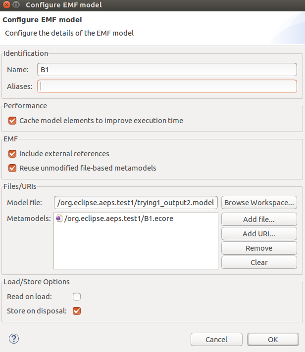

Re: Type in Ecore not found [message #1749257 is a reply to message #1749255] Sun, 04 December 2016 11:19 Go to previous messageGo to next message
As long as your model is named B1 in the model configuration dialog of your run configuration this should work fine. If it doesn't, could you please put together a minimal example [1] we can use to reproduce this?

Re: Type in Ecore not found [message #1749271 is a reply to message #1749257] Sun, 04 December 2016 23:51 Go to previous messageGo to next message
Dimitris Kolovos wrote on Sun, 04 December 2016 16:19
Cheers,
Dimitris
[1] https://www.eclipse.org/epsilon/doc/articles/minimal-examples/
Hi Dimitris,
Thanks for pointing out the problem. The model was not named B1 in the model configuration window previously and I think that's what caused the problem.

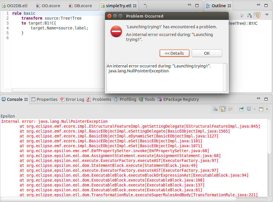

However, I am still having issue in launching this transformation Sad. Now, I am getting a Java runtime null-pointer exception. Please find attached screenshots. As you will see, for making it simple, I used the 'tree.model' from epsilon example directory as the input and B1.ecore as the metamodel of the output. Am I doing anything wrong?

Hi John,
It appears that the Name attribute of your Cla1 class is missing a type (the way I found out was by opening J1.ecore, right-clicking on the J1 EPackage and selecting "Validate"). Setting its type to EString seems to be doing the trick.

icon14.gif  Re: Type in Ecore not found [message #1749342 is a reply to message #1749339] Mon, 05 December 2016 12:01 Go to previous message
Dimitris Kolovos wrote on Mon, 05 December 2016 16:12
Hi John,
Cheers,
Dimitris
Yes, it worked! Thank you very much.
