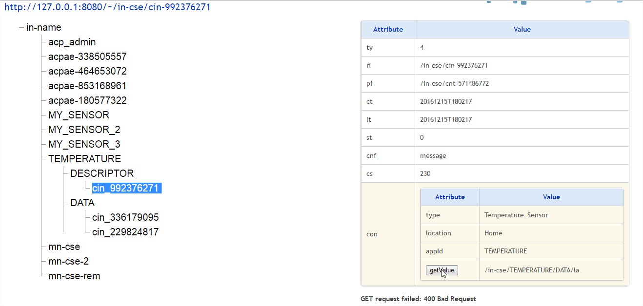

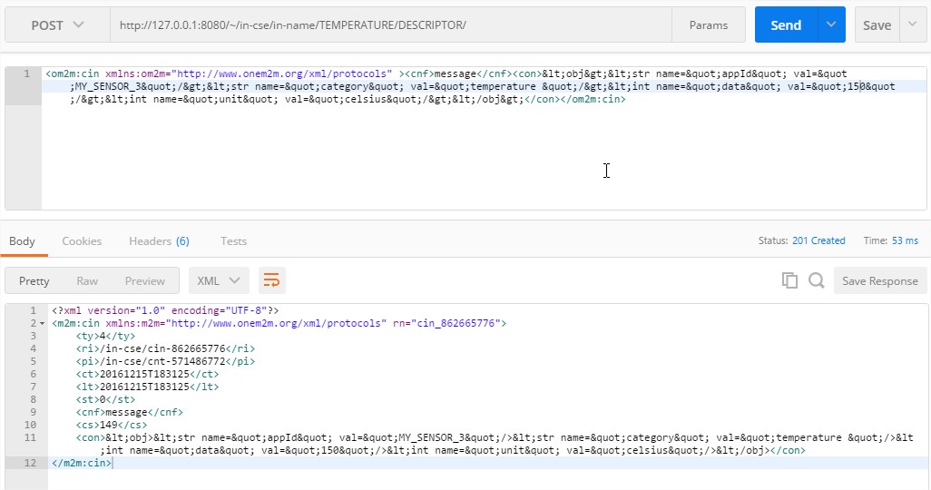

i've been able to create a TEMPERATURE sensor APP on my server (not possible on the gateway) and the main problem is that, when i try to update the sensor value using a POST request, it's not working, i think i'm not wel retargeting the good container or the sensor has been not well created,
Find attached my screen capture of the temperature sensor,
then i use POSTMAN to try to update/retrive the sensor value , (not working)
When i copy the same datacreation code, it jus create another container instance and store the value inside it, but me i jus want to be able the update the sensor value, and also get it directly, using the GetValue buton.
So please, if you could send me a tutorial on how to POST data to update a sensor value
and how to retrieve a sensor value also, using GET request, with clear URL, Clear Body,

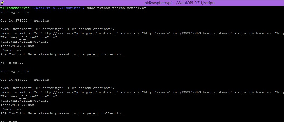

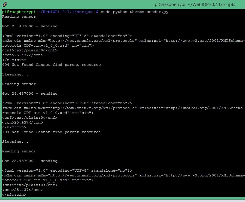

i've been able to find and understant how to post data, but façing some issue when trying to update / container instance of my sensor applacation,
when i POST the XML data, i get this message : " 409 Conflict Name already present in the parent collection. " ,
Here is my XML content :
<?xml version="1.0" encoding="UTF-8" standalone="no"?>
<m2m:cin xmlns:m2m="http://www.onem2m.org/xml/protocols" xmlns:xsi="http://www.w3.org/2001/XMLSchema-instance" xsi:schemaLocation="http://www.onem2m.org/xml/protocols CDT-cin-v1_0_0.xsd" rn="cin">
<cnf>text/plain:0</cnf>
<con>24.437</con>
</m2m:cin>
If some one can give me the good xml query content to update a container instance
Re: reel sensor discovery on the beagleboard/raspberry pi [message #1750243 is a reply to message #1750143] Mon, 19 December 2016 04:29 Go to previous message
Hi Cyril,
BE careful when you post your new instance of data you specify a resource name (rn) in the payload. However this name should be unique regarding to all the content instances in the same container. This is why you get this error because you try to create multiple content instances with the same name. You can just not specify any name and the platform will generate a unique one.
Link to this topic also regarding the update of content instance: https://www.eclipse.org/forums/index.php/t/1083202/
