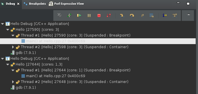

Even if they are the same program, you should be able to start a debug session on the first then, while it's running, start a second.
They will both be in the Debug View.
Here's an example of debugging two copies of the same program. It could easily have been two different programs.
Don't know why the button would be grayed. Mine doesn't. You may need to use the Run menu instead.
index.php/fa/27754/0/
