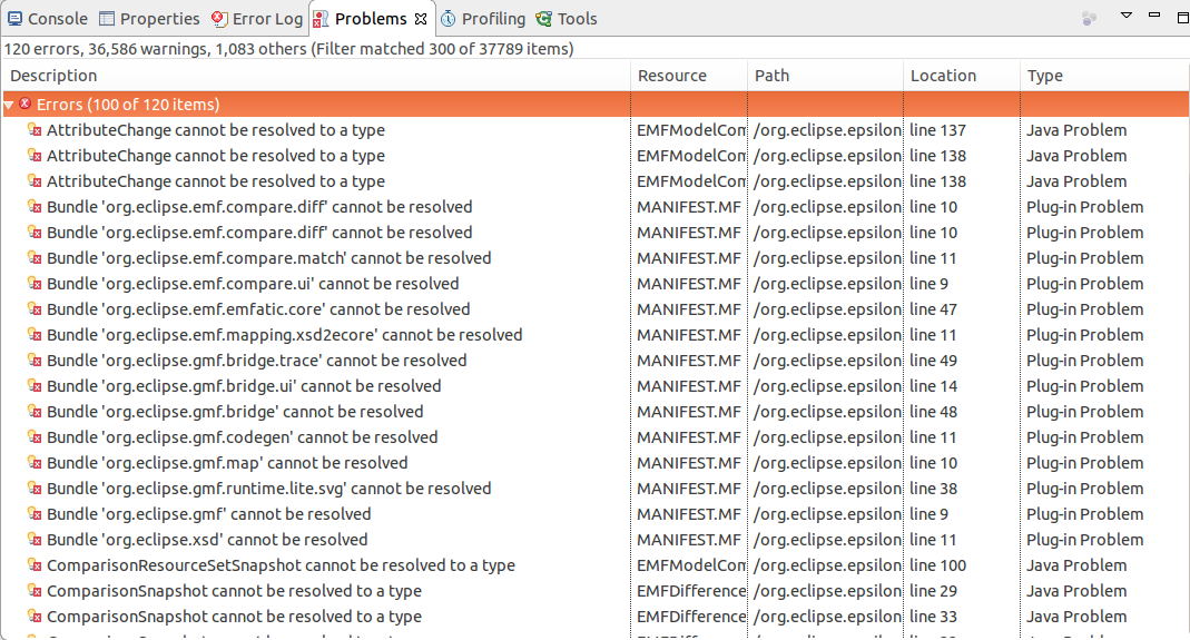

Thanks for the response. I am not sure if I am doing anything wrong, but I am having some errors in my eclipse project after cloning the git repository: git://git.eclipse.org/gitroot/epsilon/org.eclipse.epsilon.git. Please find the attached screenshot for a compact view of the errors. I also tried to run the .launch file for one of the examples (oo2db), but the console output only shows "Running ETL". Please let me know if I am doing anything wrong here. Also, if you have a video uploaded anywhere showing the entire process for a beginner, please post the link here.

You only need to import projects under /examples if you don't intend to run Epsilon from source (e.g. if you have downloaded a pre-built Epsilon distribution or you've installed Epsilon through the Eclipse Marketplace or one of its update sites). The behaviour you're encountering with the ETL transformation sounds right; the message is due to the println() statement on line 2 (ETL does not produce any start/end messages by default). After executing oo2db.etl you should also find that a DBInstance.model model under org.eclipse.epsilon.examples.oo2db/models, which is the outcome of the transformation.
