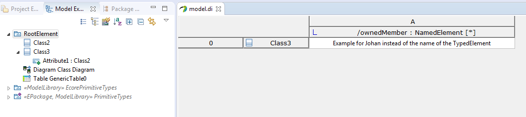

please found in attachment a sample plugin to override the label of the cell for a TypedElement. In addition, I set a snapshot of the result.

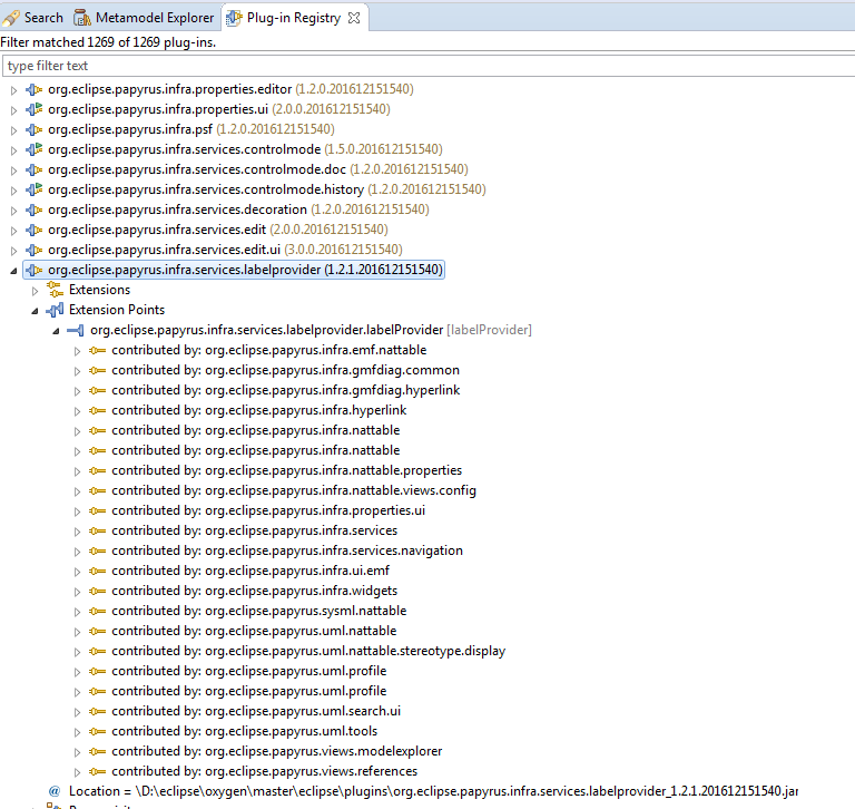

FYI, you can show all registered contribution for an extension point (it required toknow which plugin provides it), thank to the Plug-in Registry view (as snapshot too).
I hope it will allow you to fix your problem.
The warning in the plugin.xml for org.eclipse.papyrus.infra.nattable.body.labelprovider is 'normal'.
To avoid to impact all the tables, you need to override the accept method to check the type of the table (see example in attachment).
Vincent.
