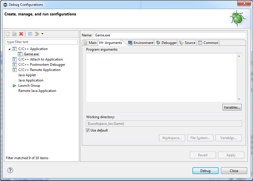

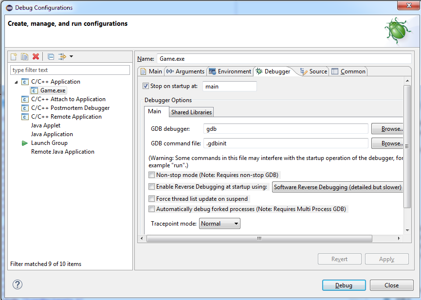

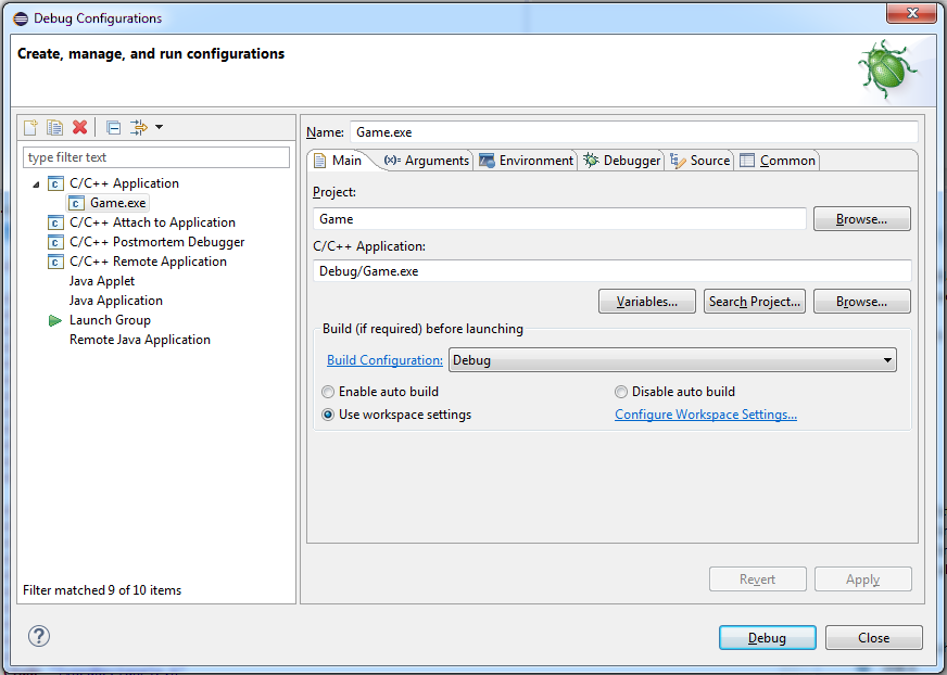

I can debug simple "Hallo World" project, but I can't debug my old project from bitbucket. My old project compilate and running, but when I try dedug it it says "<terminated, exit value: 0>gdb (7.6.1)".
Location of old project is "E:\Programming\Repository\git\game", location of new "Hallo world" project is "E:\Programming\workspaces\hallo". What wrong with my old project? I use MinGW.
