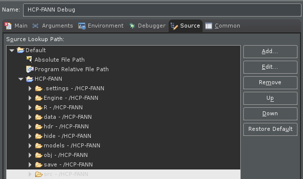

Here is the default debug dialog source tab settings for one of my projects:
index.php/fa/27667/0/
The entire project view has been added automatically,
I don't have any subdirectories in my source directory but, since all of the directories in the project have been included, I can only assume any subdirectories would have been included.

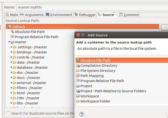

Your image shows a tree of source path containers, not a file system tree. Here is what it looks like on my system.
index.php/fa/27675/0/
So the little blue folder icon is a "project" source container that have as an attribute (parameter) the absolute file system directory for the project. The items underneath it are file system directory source containers that should have as an attribute a file system relative or absolute path. So the combination of the project source container and file system directory source container and its children should provide atributes to construct a file system path to the source files (I think Confused ).
My problem is that I cannot work out why it is not working on my system because I cannot "edit" the default container or its children to see what their current attributes are.
