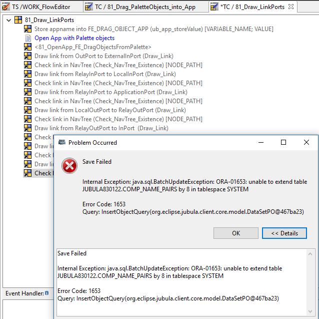

i wanted to extract some part of a test case into a new and capy and pasted the lines into the new test case.
it was not possible to copy-paste all lines at once because there were some comments between them (selecting them results in copy is disabled).
so i copy-pasted two lines seperatly and added the comment in new case and saved the editor without errors.
finaly i copy-pasted the last 14 lines (without the comment) into the new case.
they appeared there and i tried to save editor again but this time two error windows opened:
Save Failed (1653)
General Database error (2016)

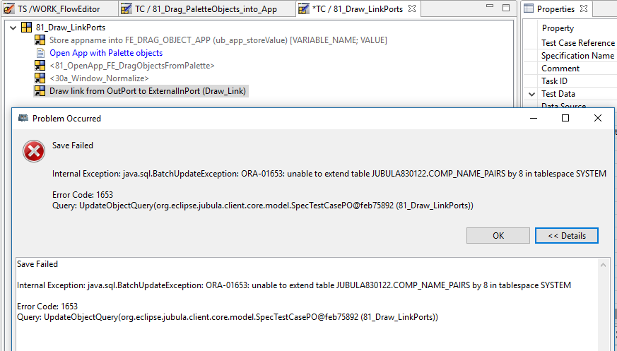

(see first two screenshots).
i tried again, but same thing.
i canceled the editor with the new case and opened again with status before copy-paste of 14 lines.
i edited other editors and saved them without problem.
then i copied only one line but again i got the errors at saving. i reverted the changes again.

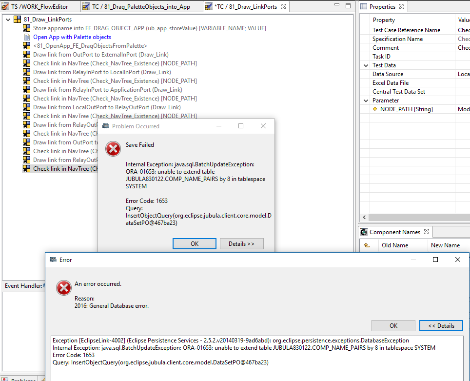

again i tried to copy one line from first test case to new one, but got errors again, slightly other than the first (see third screen).
i reverted the changes again and refreshed the project, but i did not help.

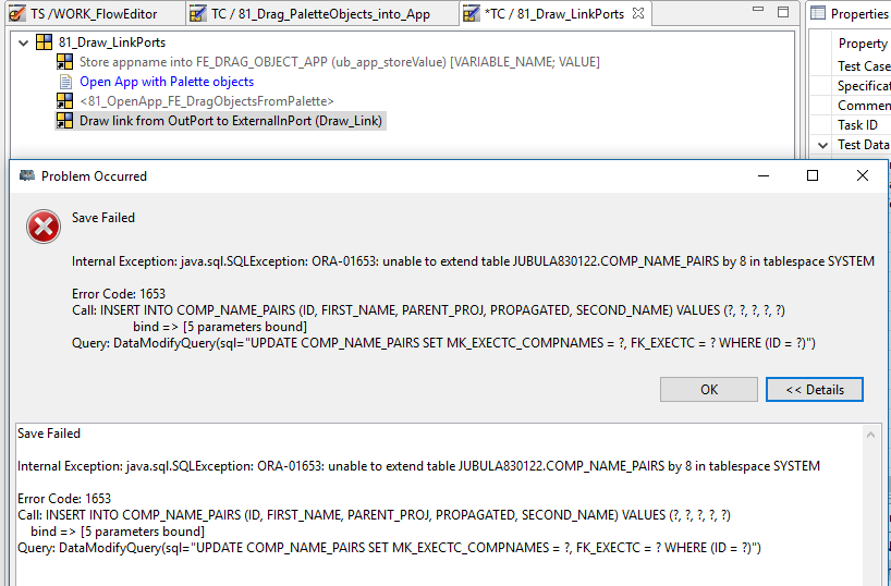

now i tried to recreate the line that i wanted to copy manually.
i dragged the test step from test case browser into editor and could save without error. i copy-pasted the reference name from old test case and saved successfuly.
now i tried to copy the component name, but failed again at saving with a different error window (see fourth screenshot).

Re: Save Failed (1653) - General Database error (2016) [message #1748462 is a reply to message #1748226] Wed, 23 November 2016 05:47 Go to previous messageGo to next message
It seems to be that some tables are going out of space.
You should ask your Database administrator to raise the tablespace of at least the table "COMP_NAME_PAIRS"
I think we cannot do anything else about this
