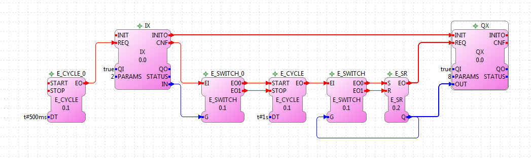

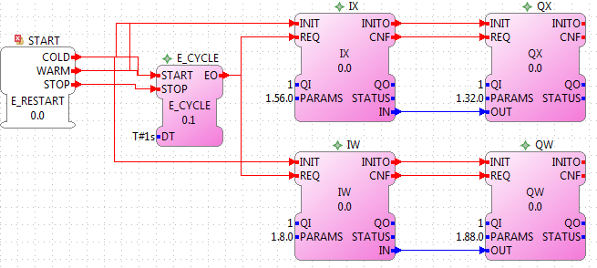

I would like to make a simple test where I switch a LED light on/off at a Beagle Bone Black (BB). I have looked the documentation and I found the most simple tutorial of the flip flop modified to work for raspberry.
I came accross 2 implementations.

The first example uses smth called RPI, from what i could tell it's some sort of support package for the GPIOs, is there something similar?
At the second example there is 1.88.0 (busChannel.deviceNumber.portNumber) could somone explain me how to translate those to the pins of the BB?

RPI is just short for the Raspberry Pi and it is no GPIO support package. The first implementation in your screenshots is exactly the way you should do it on the Beaglebone Black (BBB).
The easiest way to use the GPIO interface of the BBB is the SYSFS interface of FORTE. You need to compile FORTE for the BBB and activate the SYSFS module in the CMAKE configuration.
You can use the IX Blocks for reading the GPIO pin and QX for writing to it (e.g. switch a LED on or off).
The PARAM should be the GPIO pin number you connected your LED to (e.g. BBB connector P8 pin 20 is GPIO pin number 63).
I don't know the Raspberry SPS very well, but if I'm not much mistaken, it uses GPIO port expanders via I2C interface, so the PARAM 1.88.0 should match the 1st I2C bus, device with I2C address 88 (the GPIO port expander chip) and the channel on the chip.
