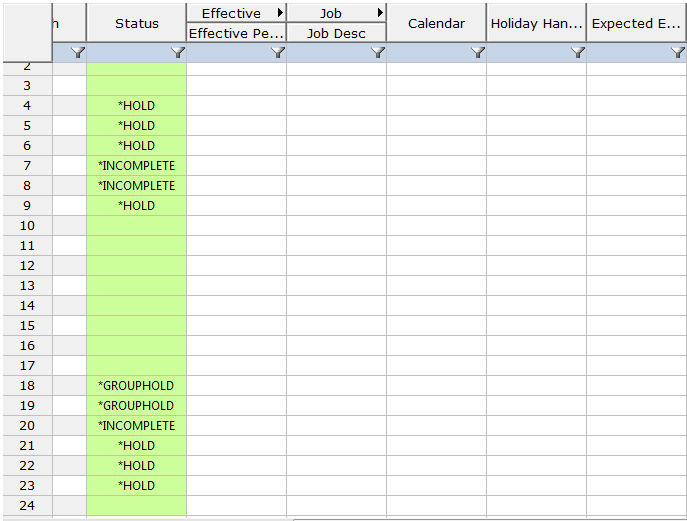

I am using NatTable1.4 on FormEditor and it works really well for small size data which doesn't require a scroll. All the rows are loaded successfully for 32 columns.
However, when I have more than 100 rows of data and scrollbar appears, and I use vertical scroll , data is not loaded/refreshed in the table. All the column values appear empty. Similar issue persist with horizontal scroll. I am testing NatTable1.4 on Win 7 machine. With what I understand, data is available but redrawing is taking time. Is there any way to improve the response time to scroll?
