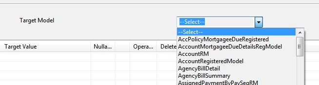

Hi, I am trying to test an eclipse RCP application. I want SWTBot to click on an item of a combo box (drop down box),
I tried bot.combo,bot.ccombo, bot.comboboxwithId but
I get a WidgetNotFoundException. Can someone show me how to access the combo and click one of its items ?
  • Attachment: cmbviwer.jpg
    (Size: 26.17KB, Downloaded 195 times)
Re: Bot Unable to find Comboviwer.. [message #1747419 is a reply to message #1747375] Mon, 14 November 2016 09:33 Go to previous message
Hi Sumit,
Whether you need to call bot.comboBox() or bot.ccomboBox() depends entirely on your application, is it using a Combo widget or a CCombo widget? Or perhaps the application could be using some custom widget that is not supported by SWTBot?
Assuming it's a Combo or CCombo, next you could try and make sure that the 'bot' is at the most narrowed scope to find your widget. Is it from a SWTWorkbenchBot? You might try to use a bot from a SWTBotShell, or from a SWTBotView. Also make sure that the Shell that contains your combo box is the active shell.
Patrick
