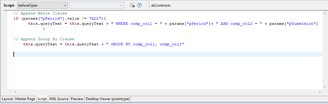

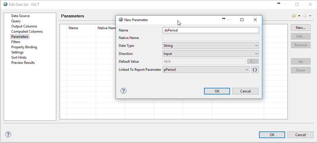

You can either substitute a '?' for the parameters and add a data set parameter linked to the report parameter or you can move the Where Clause and Group By to the beforeOpen method of the data set. (See images)
index.php/fa/27577/0/
index.php/fa/27578/0/

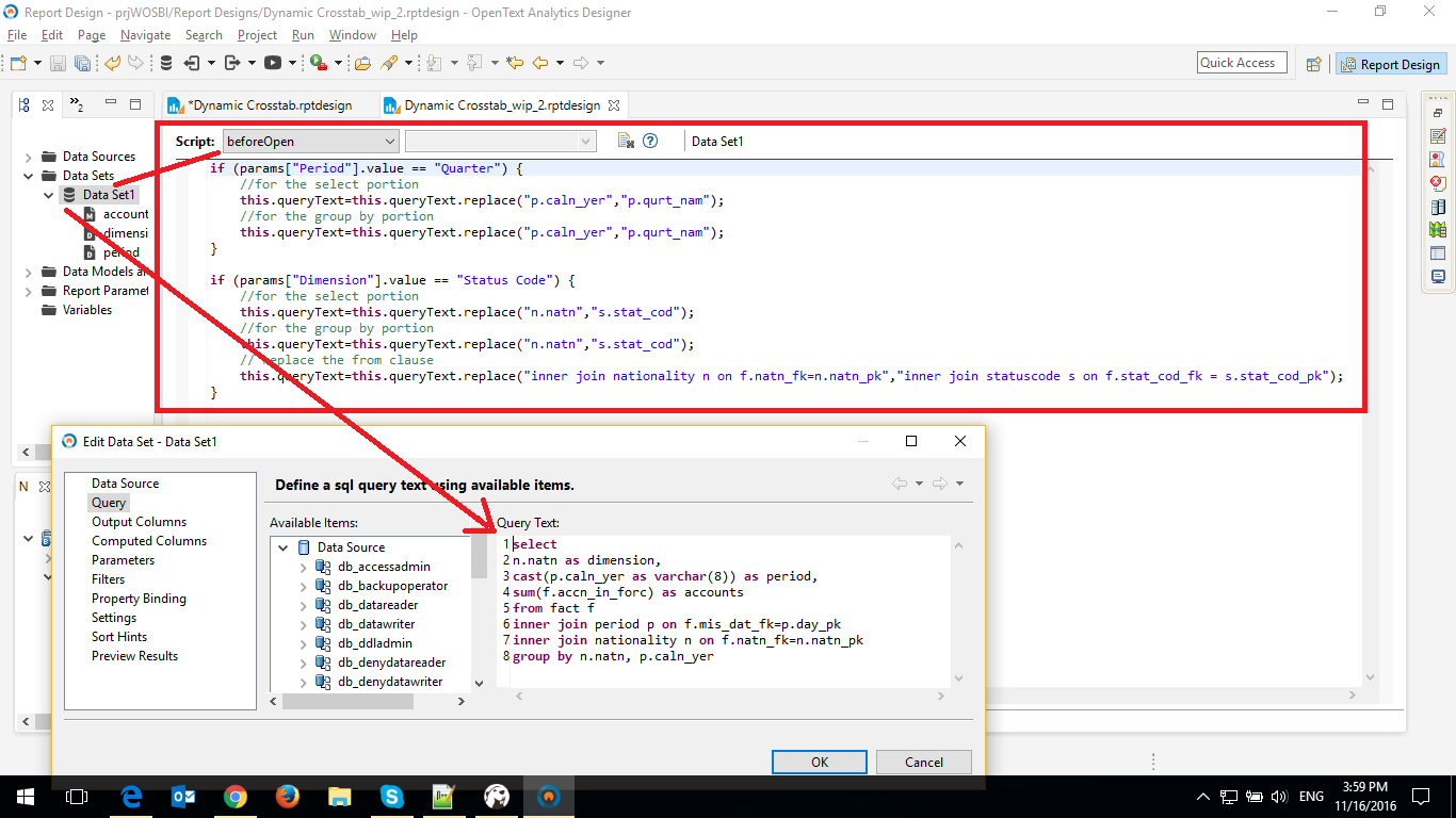

index.php/fa/27598/0/
But I am getting the foll. error:
Caused by: java.sql.SQLException: [ActuateDD][SQLServer JDBC Driver][SQLServer]The multi-part identifier "s.stat_cod_pk" could not be bound.
I have checked the script for spaces and typos. All seem correct but still the above error. Also, the same reportdesign but with different dimensions using CLASSISMODELS is working fine!
My report design attached.
Best Rgards

I have done it the beforeOpen way. I am building my dataset query dynamically by adding the Select, From and Group By items into the beforeOpen script.
Best Rgards
Problem Solved!! Smile
In the beforeOpen script, for the params[Dimension], I just placed the From clause this.queryText.replace expression at the top, followed by the Select clause expression and then finally the Group By clause expression.
It's working now.
