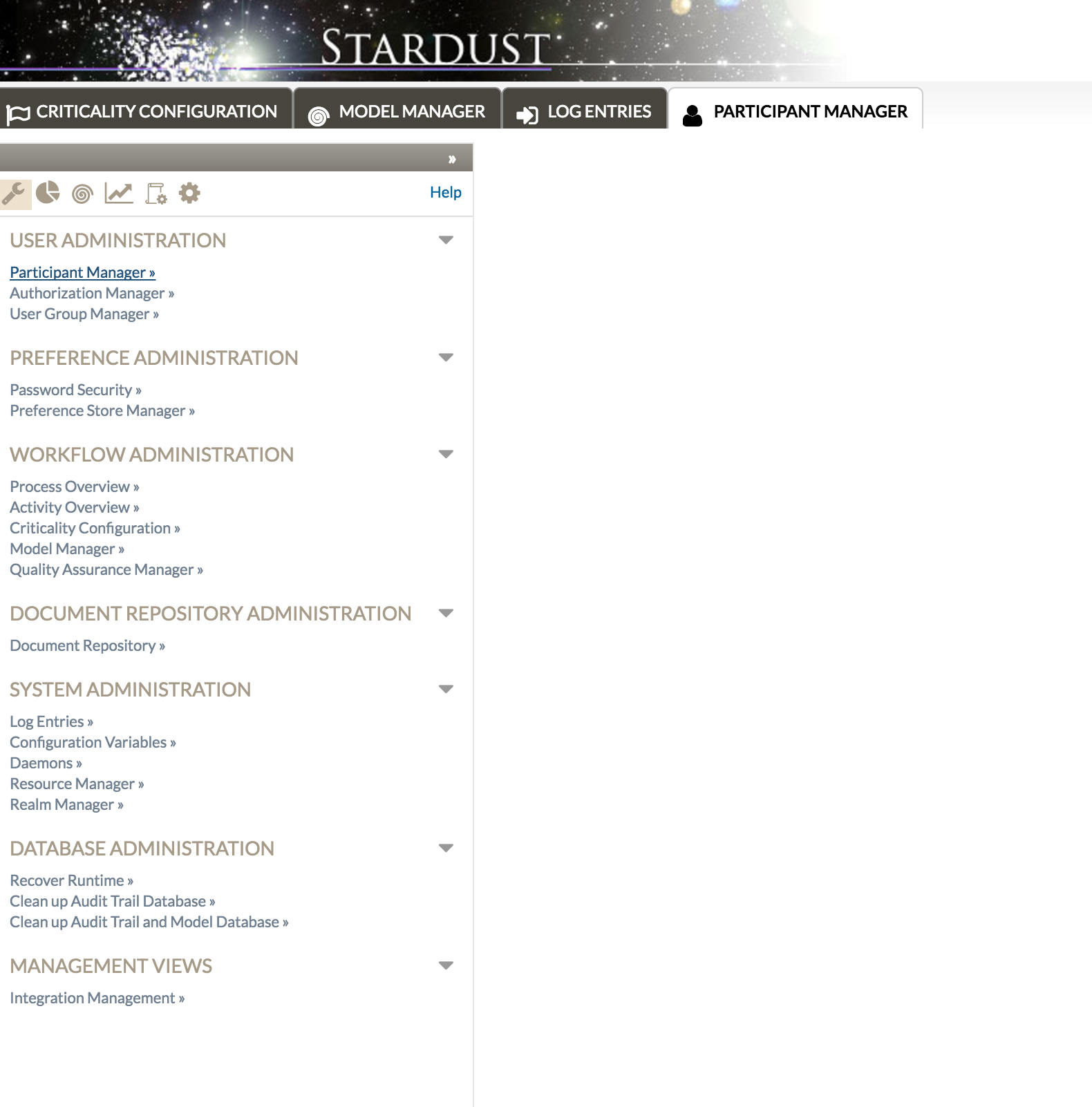

Stardust portal-Participant Manager Tab empty [message #1747346] Sat, 12 November 2016 18:42 Go to next message
I completed the Support Case Management tutorial using Eclipse Neon.1
After deploying the model to tomcat and succesfully logged to the portal the link to "Participant Manager" , the tab shows empty.
Also the Workflow Execution tab is displayed with the labels {{TITLE}} in every row.
I tried firefox and chrome.

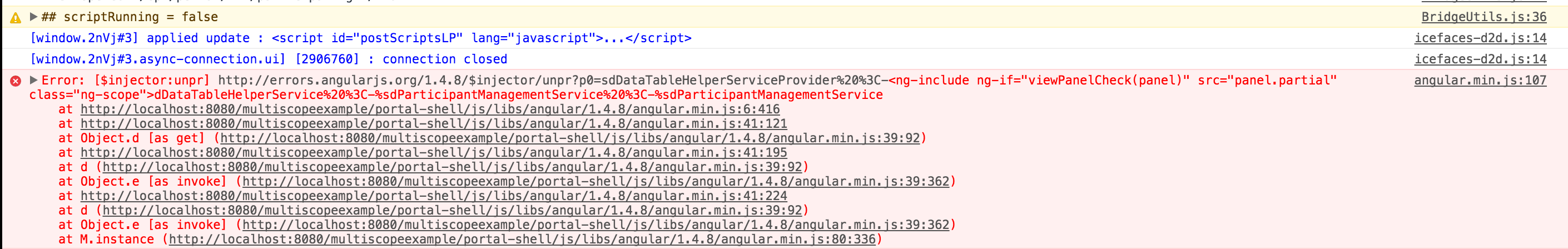

Hi Again
There is an error in the page when i clicked the "Paticipant Manager" link.
The image is attached.
Re: Stardust portal-Participant Manager Tab empty [message #1748544 is a reply to message #1748081] Thu, 24 November 2016 04:21 Go to previous message
the Root cause of this issue is a syntax error in sdBusinessObjectFilterDialog.js. due to which the Stardust Portal is failing to initialize.
The issue will be addressed by https://bugs.eclipse.org/bugs/show_bug.cgi?id=507686
In the meantime it should be possible to change this manually. There are two extra curly brackets (}) in lines 36 and 60 which need to be removed.
Sorry for the inconvenience.
