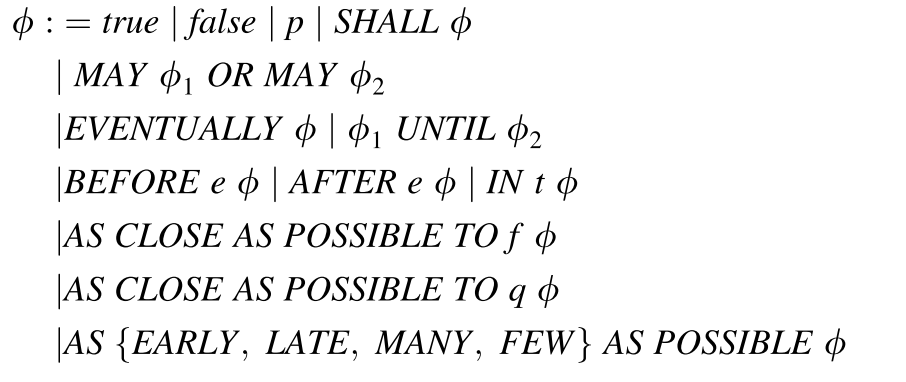

Hello guys,
I have a problem with the left recursion, I need to represent a grammar, but it's a bit strange grammar for those accustomed to formal languages.
The grammar makes references to itself several times, and it is all represented in a single rule (a giant one). It is an academic work, and I am not able to transcribe the grammar of the paper for Xtext grammar language, I will attach an image , Which contains the proposed grammar, my results so far are these:
Relax:
	root+=General+;
terminal BOOLEAN returns ecore::EBoolean:
    'true'|'false'
General:
	root+=BOOLEAN|STRING|ShallOperator|MayOperator|EventuallyOperator|UntilOperator;
ShallOperator:
	'shall' elements=General;
MayOperator:
	"may" action1=General 'or' action2=General;
EventuallyOperator:
	'eventually' element=General;
//HERE IS THE ERROR
UntilOperator:
//	{General.left=current}'&' right=General;
//	({General.left=current}) 'until' element2=General;
	left=General 'until' right=General;
The error displayed is: "this rule call is part of a recursive call graph" on the line
Left = General 'until' right = General;
I already researched this, but I could not apply a solution in my situation, as you can see in the commented lines.
I'm new to Xtext, I need help with this, and I take this opportunity to ask if I'm representing the grammar correctly in Xtext (see attached original grammar).
Any help is welcome.
Thank you.
  • Attachment: relax.png
    (Size: 68.35KB, Downloaded 225 times)

Hi, thanks for the reply.
Can you please explain the code to me? Especially the part of the "until" operator, or indicate materials to study this on their own?
I put your grammar here, syntax errors (in grammar) do not exist, but it does not allow the formulation of valid sentences, for example, this would be a valid sentence:
the ventilation shall work until the environment is cool.
However, the natural language strings contained in "STRING" are apparently not allowed. Any idea?
I have studied formal languages on graduation, but I never before developed one.
Again sorry, I do not have much knowledge about compilers, or DSLs, any help is welcome.
Thank you very much

I made this rule this way because I'm trying to translate the grammar, and in the original grammar this is something like this:
G = simple and general grammar rule with a lot of recursive calls.
AS CLOSE AS POSSIBLE TO f G
In the original grammar, this rule (G) has several recursive calls, I do not know if I'm doing the right thing in Xtext, but there, I have no rule for "f", I just know it's some input, however it should be possible to continue writing the phrases.
