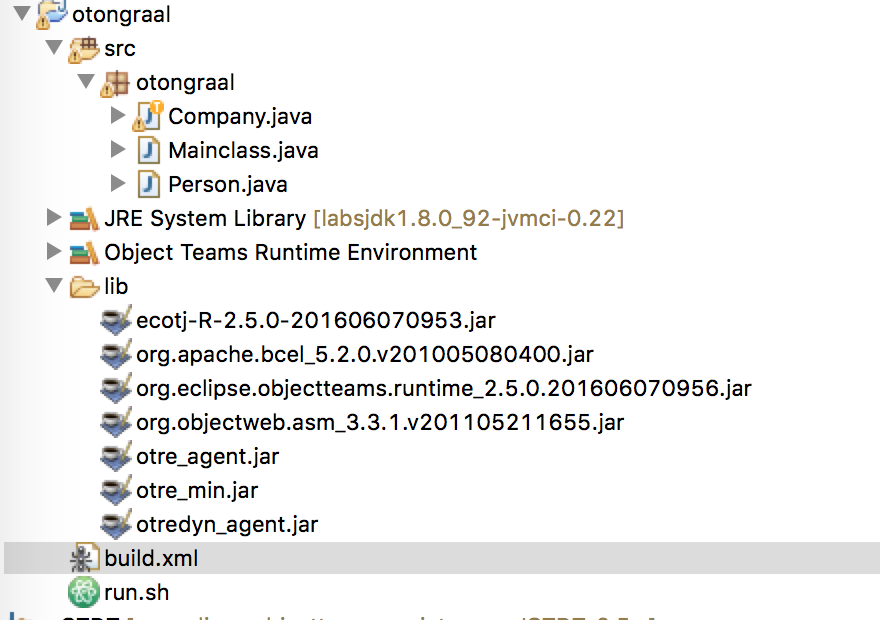

What I have is both an ant build script and a single command which should both do the same. They both result in the same error message.
As you can see I added the Eclipse plugin directory into the class path where jdt.internal.compiler.apt is contained. I have read all the provided information about compiling from command line.
The lib folder contains the required runtime jars, the OT compiler. Building from within Eclipse is fine. When build from within Eclipse and running from command line

For convenience I added all files as zip (but be aware of the hardcoded class path entries).
I want to be able to build from command line (would be a plus) and run from command line (mandatory). For now I tried everything that has been documented in the wiki, the blog and what I found in this forum. Thank you very much for your help.

Re: Compile and launch from command line [message #1747201 is a reply to message #1747161] Thu, 10 November 2016 11:47 Go to previous messageGo to next message
Found it: you need to use a newer version of asm, and then asm is split into multiple jars (paths and some version numbers omitted for simplicity):
java -javaagent:otredyn_agent.jar -Xbootclasspath/a:otre_min.jar -classpath .:otredyn.jar:org.objectweb.asm_5.0.1.v201404071650.jar:org.objectweb.asm.commons_5.0.1.v201404071650.jar:org.objectweb.asm.tree_5.0.1.v201404071650.jar:org.eclipse.objectteams.runtime.jar otongraal.Mainclass
This runs and prints:
Hello, my name is Hans Peter. How may I help you?
Hi, I am Maya Maier. I have a problem!
HTH,
Stephan
[Updated on: Thu, 10 November 2016 11:56] by Moderator
Re: Compile and launch from command line [message #1747206 is a reply to message #1747201] Thu, 10 November 2016 12:20 Go to previous messageGo to next message
I've updated https://wiki.eclipse.org/OTHowtos/Running_From_Commandline
Let me know if anythings is still amiss,
Stephan
Re: Compile and launch from command line [message #1747220 is a reply to message #1747206] Thu, 10 November 2016 16:20 Go to previous messageGo to next message
Unable to load annotation processing manager org.eclipse.jdt.internal.compiler.apt.dispatch.BatchAnnotationProcessorManager from classpath.
That was https://bugs.eclipse.org/507370, which is fixed now. Passing -proc:none should no longer be necessary (a freshly built ecotj.jar is linked from the bug).
Stephan
[Updated on: Thu, 10 November 2016 16:22] by Moderator
Re: Compile and launch from command line [message #1747253 is a reply to message #1747206] Fri, 11 November 2016 04:46 Go to previous messageGo to next message
Stephan Herrmann wrote on Thu, 10 November 2016 18:20
Stephan
Now all is working and I can run from the command line. Thank you very much!
Cheers,
Lars
