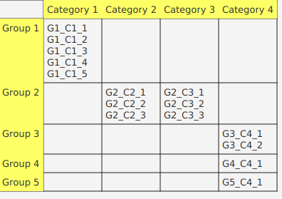

I'm developing a GEF4 application (which should be used as an eclipse plugin). I've done a lot of research and looked at the MVC example on github but one question still remains.
The requirement that I have is that the view has to "look" like a spreadsheet or something like that. The model can shortly be described as follows: we have different categories on the x axis and some groups on the y axis. Each category has one column assigned. For the groups there can be multiple entries in one row (nested).
Since my knowledge in GEF is very limited and I haven't found any useful stuff on the internet, is it possible to realize something like that? I stuck on how to design the data model / how to model my requirements correctly. That means how to dynamically build a grid and put the content in the correct cells (matching category and group). The data is read from an EMF instance. In a pure JavaFX Application, I have used a GridPane and added nested GridPanes where necessary to handle the nested y-rows, it works. I have attached a screenshot of the view of this small application. But I have no idea how to get a good starting point for doing this with GEF / how to put my data in a model that can be used.
index.php/fa/27539/0/
Thanks for any hints!

Hi Onke,
so you have the following model: One Group object contains multiple Entry objects which have a category assigned, i.e.
class Model { List<Group> groups; List<Category> categories; }
class Group { String label; List<Entry> entries; }
class Entry { String label; Category category; }
class Category { String label; }
You want to display one column per category, display one row per group, and display the entries in the correct cells.
There are different approaches to that: 1) ModelPart that directly renders groups, categories, and entries; 2) ModelPart that directly renders groups and categories, but reports entries as content-children, so that EntryPart renders a single entry (ModelPart handles insertion/removal of EntryParts and their visuals); 3) ModelPart that only renders the GridPane and handles the insertion/removal of GroupPart, CategoryPart, and EntryPart, which render their labels/data themselves.
Depending on how you want to tailor the content-parts, the ModelPart's methods need to be implemented in a certain way:
1) ModelPart has the Model as content, no content-children (doGetContentChildren()), one GridPane visual (createVisual()) that is filled with groups, categories, and entries during doRefreshVisual().
2) ModelPart has the Model as content, returns entries as content-children, and renders a GridPane that is filled with groups and categories during doRefreshVisual(). Entries are controlled by EntryPart, therefore, ModelPart needs to implement addChildVisual() and removeChildVisual(), which insert the given child into the respective grid cell.
3) ModelPart has the Model as content, returns groups, categories, and entries as content-children, and renders a GridPane. doRefreshVisual() does nothing. Groups, categories, and entries are controlled by GroupPart, CategoryPart, and EntryPart, respectively, therefore, ModelPart needs to implement addChildVisual() and removeChildVisual(), which insert the given child into the respective grid cell.
The content-parts are organized in a hierarchy, but the underlying model does not need to be organized. Complementary to the content-part hierarchy, you can use anchorage-anchored relations between any content-parts. Generally, these are used to connect parts that are not connected via their parent-child relation, e.g. connections and labels.
Matthias
