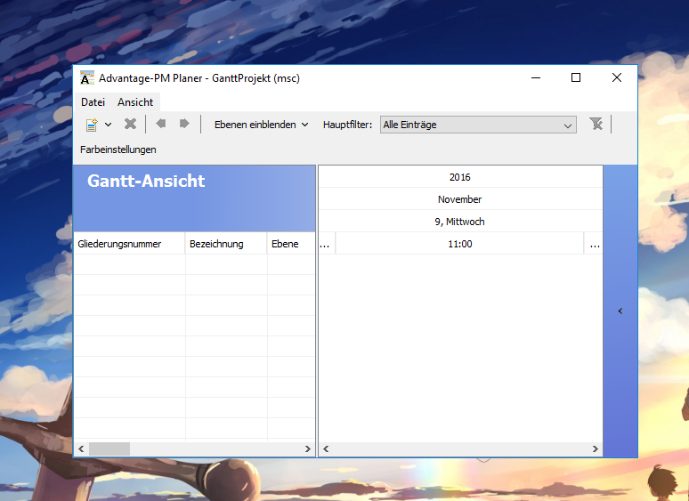

Yes, you were right, i am using Swing.
index.php/fa/27538/0/
That is my Frame and yes, it has focus.
Also, sending the external key combination was successful, it is just that nothing happend.
greetings Marcel
Re: Closing a Frame [message #1747235 is a reply to message #1747092] Fri, 11 November 2016 01:02 Go to previous messageGo to next message
Hi Marcel,
Just a silly question - if you manually send alt+f4, does the window close?
If alt+f4 isn't working, you can try using File-Close via the menu. At this point though, I'd be interested in knowing why you want to close the window. It looks like this is the only application window and so closing it would close the application - is that correct? If so, can you tell us why you want to close it (during a headless run, the application is closed at the end of the test anyway, and we have "restart" actions to restart the application during a test).
Bestr regards,
Alex
Re: Closing a Frame [message #1747240 is a reply to message #1747235] Fri, 11 November 2016 03:08 Go to previous messageGo to next message
Hey,
Yes, sending it manually works fine, that's why i was wondering that it doesn't work.
About closing it over the file menu ... there is no 'exit' and the window isn't the only one, there is one that is minimized which will come back to the foreground as soon as the Gantt window closes.
greetings marcel
Re: Closing a Frame [message #1747254 is a reply to message #1747240] Fri, 11 November 2016 05:01 Go to previous message
Hi Marcel,
I just tried this on Windows 10 with a Swing AUT and for me sending ALT + F4 works correctly. To send the combination I used the "ub_app_pressAnyKeyCombination_ALT" referenced test case of the concrete unbound modules and entered "F4" as value for the BASE_KEY-Parameter.
If this is not working for you there is another way to achieve closing a window on Windows. To do so you can try to send the key combination ALT + SPACE which opens the context menu of the application's header bar. Then you could send a "C" or alternatively press five times the down arrow key and hit enter.
Kevin
