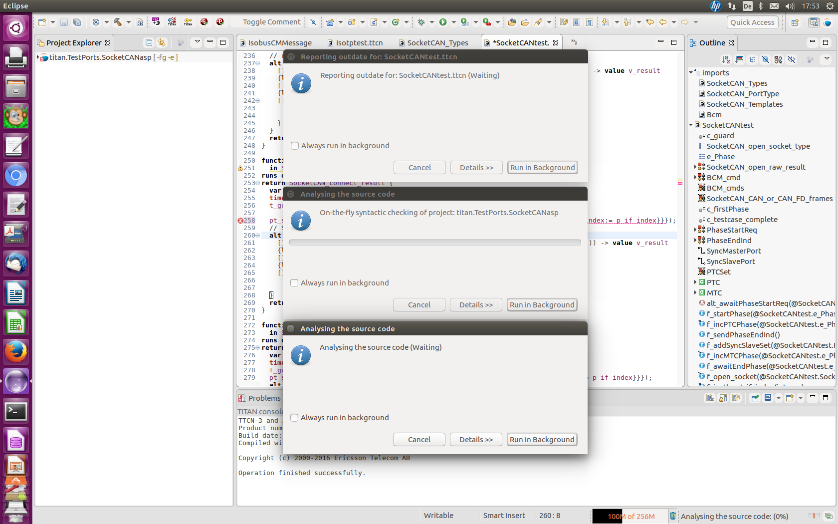

I get the attached error message after changing some TTCN-files. I have reinstalled eclipse, cleaned the workspace, recreated the project. Started eclipse with -clean option in eclipse.ini file, removed the .lock file in the workspaces metadata and tried all other recommendations I have found. Nothing helped.
I am using eclipse under ubuntu 16.04. I noticed that after ecplise titan reinstalled the "Titanium feature" package did not install due to dependency problems.

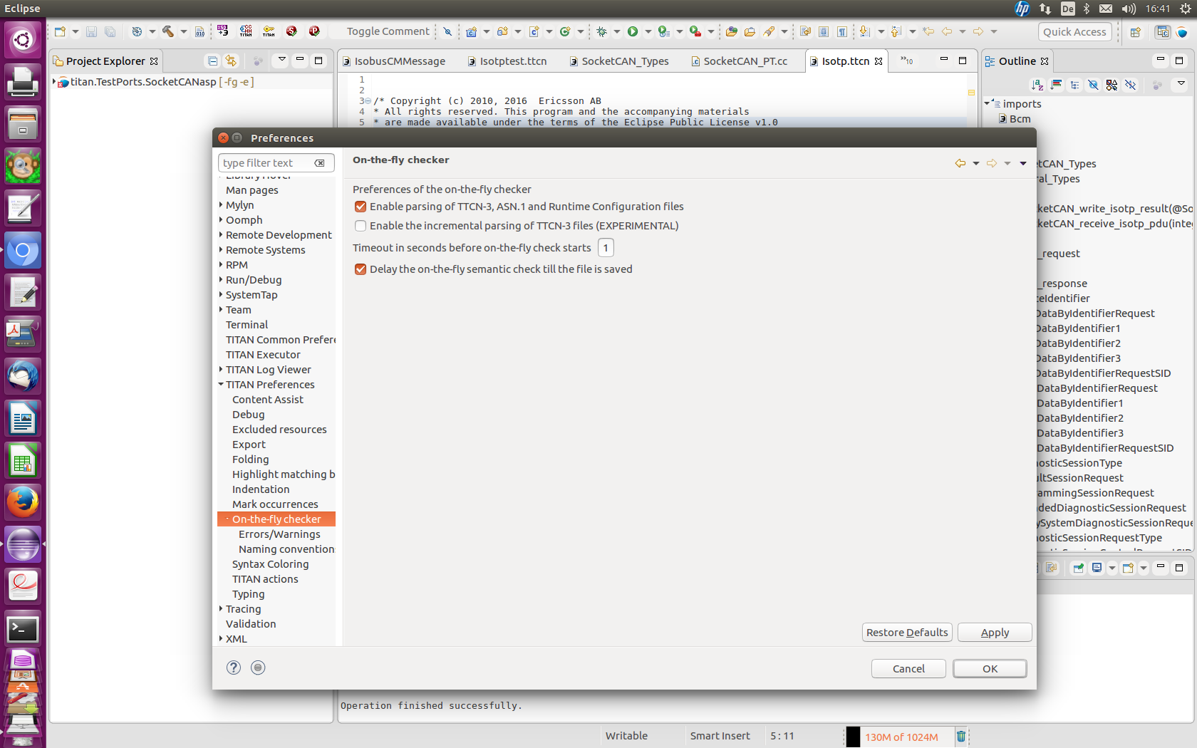

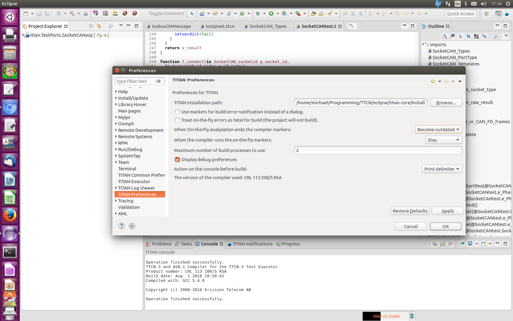

Please go to the Window / Preferences / TITAN Preferences and enable the "Display debug preferences" option, when you press the Apply button a new preference page with the name "Debug" will appear right below the TITAN Preferences page.
On this debug page you can enable "Enable debug console".
This will do 2 things that can help us proceed:
- the on-the-fly analyser running in the background will appear in the progress window.
- we will display some information on the Console View that can be used to debug, why these operations take too long.

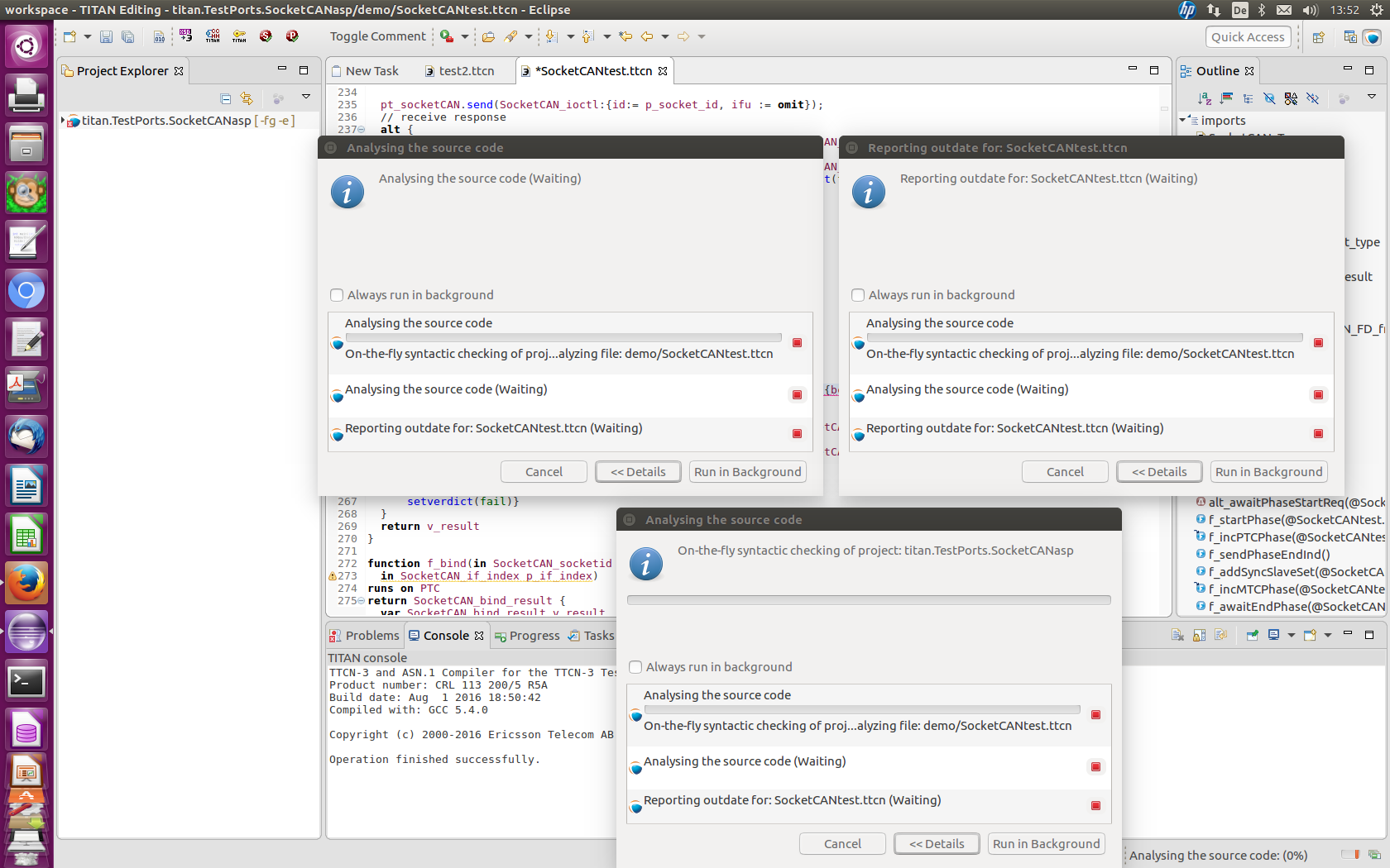

looks like the analyzer stalls. Please find the make archive attached.
The error occurs when changing e.g. line 258 in SocketCANtest.ttcn the the word 'params' to 'connectu'.
Re: Eclipse Titan hangs due to waiting user operation [message #1746898 is a reply to message #1746897] Mon, 07 November 2016 08:24 Go to previous messageGo to next message
Please try entering the letters of 'connectu' letter by letter. It might be due connect being a keyword (and maybe 'param' without 's' also a keyword).
I've terminated Eclipse and changed the word with an other editor, made a similar change to 'bindu' in line 280 and reopened it with Titan again. Now the problem did not reappear.

The text besides always tells 'Analyzing the source code (0%)'

If you have the debug output enabled you should have the debug console working ... but it is really not that obvious to find in eclipse for the first run.
In the toolbar of the console view there is an computer shaped icon, with a drop down option ... that is where you decide which console's output you wish to see in the console view window.
(fun fact: it is possible to create as many console views as you like, each displaying something different to observe several outputs at the same time).

> Window/Preferences/ TITAN Preferences/On-the-fly checker and disable the option "Warn and disable parsing before the system runs out of memory".
There is no such preferences option in my Titan preferences tab. The option "Treat on-the -fly error as fatal for the build was not activated. See attachment.
When activation above option nothing changes. See attachment.

Re: Eclipse Titan hangs due to waiting user operation [message #1747351 is a reply to message #1747200] Sun, 13 November 2016 05:57 Go to previous messageGo to next message
Hi Michael,
The "TITAN Preferences" can be expanded in the left hand panel, to provide you with more customization options.
When you expand it you will see the "On-the-fly checker" preference page among others.
There you can check out some of the performance affecting options:
- you can find here the out of memory related option, I mention earlier.
- you can delay the semantic checking until you save a file. This way while you are editing the load on your machine is smaller as only syntax checking is done ... but this also means that internal semantic information is becoming outdated.
- you can also set how much after your last change the code checking should start. If you have high load, or synchronization issues it might be a good idea to increase it to 2-3 seconds
This "On-the-fly checker" page can also be expended if you wish to configure the severity of how naming convention violations and some other issues should be reported.
Re: Eclipse Titan hangs due to waiting user operation [message #1747520 is a reply to message #1747351] Tue, 15 November 2016 10:43 Go to previous messageGo to next message
Hi Kristof,
I do not find such options. Please see screenshot.
Michael
Re: Eclipse Titan hangs due to waiting user operation [message #1747578 is a reply to message #1747520] Wed, 16 November 2016 03:38 Go to previous messageGo to next message
Hi Michael,
As the memory configuration option is truly missing, If I'm not mistaken you are using an older version of the plugins.
One way to proceed forward could be to check if you can update your plugins to the newest (5.5.1) version, to see if the issue still persists.
On the other hand we are just a few days from release -ing a new version,
I have corrected an inconsistency issue with our handling of the CountDownLatch, which class is also present in the stack traces you have sent.
So it could very well be, that this version will already fix the issue you are experiencing.
And we just have to wait for this release and try it out.
