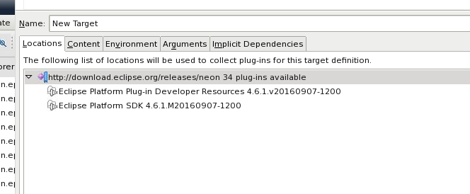

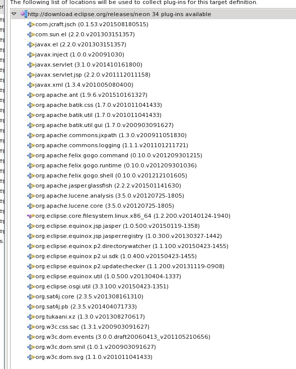

It's weirder than I thought. When I create a new target definition and add just the Platform SDK and the PDE, it gives no error when reloading, but the list of bundles is missing almost everything.
index.php/fa/27546/0/
index.php/fa/27547/0/
I tried to clean up everything (.eclipse, workspace), I ran with both Mars and Neon, I can't make it work again and I don't understand anything...
Does anyone have an idea?

Update: it works if using the Luna or Oxygen update sites, but not from Mars or Neon. Shocked
It doesn't seem related to the update sites themselves, as we have our own local mirrors and they behave the same...
