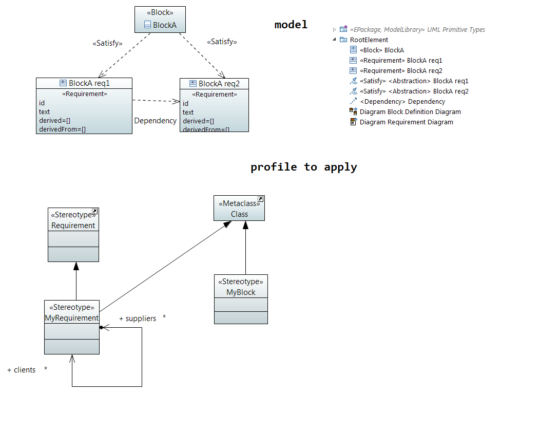

I have a sysml input model, in which there are a block element that satisfies two requisites, one of them is dependend by the other (see the attachment).
I want to build a transformation in a output model in which the input models are the input model and the profile model.
The rules are very trivial:
Foreach block, i have to obtain an element MyBlock, with all the requirements that satisfies as own Nested Classifiers.
Requirements are mapped in stereotyped class MyRequirement, having two tagged values: clients and suppliers.
Clients are depending MyRequirement-s from a single Requirement, suppliers are the inverse.
I'm able to generate the instances of MyBlock and MyRequirement, but i'm not able to set the tagged values clients and suppliers.

Attachment: Immagine.png
(Size: 48.79KB, Downloaded 324 times)
