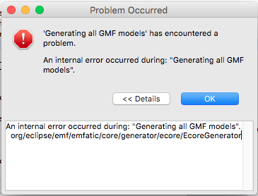

Error when trying generated ecore file [message #1746455] Sat, 29 October 2016 11:14 Go to next message
Hi all,
When I click on my .emf file with the right click on mouse, and then Eugenia > Generate Ecore Model I always get this error:
index.php/fa/27455/0/
"An internal error occurred during: "Generating all GMF models".
org/eclipse/emf/emfatic/core/generator/ecore/EcoreGenerator"
Someone can help me on this? Why this error is showing up every time?
I'm using Eclipse Mars.2 Release (4.5.2) on Mac.
Cheers
  • Attachment: error.png
    (Size: 35.15KB, Downloaded 1060 times)

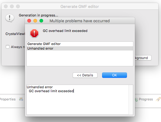

Re: Error when trying generated ecore file [message #1746460 is a reply to message #1746459] Sat, 29 October 2016 12:05 Go to previous messageGo to next message
The details option just show me this message:
And now I'm trying to click in my .ecore file and Eugenia > Generate GMF Editor and I'm get this error also:
index.php/fa/27457/0/
"Unhandled error
GC overhead limit exceeded"
Sad
  • Attachment: error2.png
    (Size: 57.80KB, Downloaded 917 times)
Re: Error when trying generated ecore file [message #1746461 is a reply to message #1746460] Sat, 29 October 2016 12:10 Go to previous messageGo to next message
Cool, my guess is, if you increase the heap space of your JVM, then this problem may go away. In your Eclipse configuration file, find the file eclipse.ini and try to increase/set the heap space size. How to do is here: http://stackoverflow.com/questions/8600972/increasing-heap-space-in-eclipse-java-lang-outofmemoryerror .
You need to restart your Eclipse afterwards.

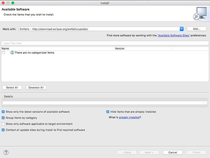

Re: Error when trying generated ecore file [message #1746520 is a reply to message #1746462] Mon, 31 October 2016 10:39 Go to previous messageGo to next message
Is Emfatic installed in your Eclipse? If not, you should install it from http://download.eclipse.org/emfatic/update
Cheers,
Dimitris

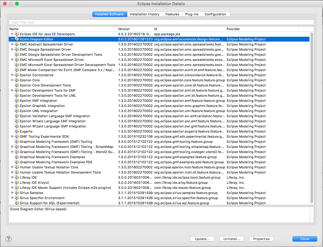

Re: Error when trying generated ecore file [message #1746593 is a reply to message #1746520] Tue, 01 November 2016 10:29 Go to previous messageGo to next message
Hi Dimitris,
I'm not sure if this link is working because nothing is appearing to me:
index.php/fa/27470/0/
These are my installed softwares:
index.php/fa/27471/0/
Can you help me on this?
Cheers.

Re: Error when trying generated ecore file [message #1746610 is a reply to message #1746593] Tue, 01 November 2016 14:10 Go to previous messageGo to next message
Emfatic doesn't seem to be installed in your Eclipse instance. Does un-ticking the "Group items by category" in the first screen do the trick?
Cheers,
Dimitris
Re: Error when trying generated ecore file [message #1746612 is a reply to message #1746610] Tue, 01 November 2016 15:05 Go to previous message
Now it works. Thanks!
