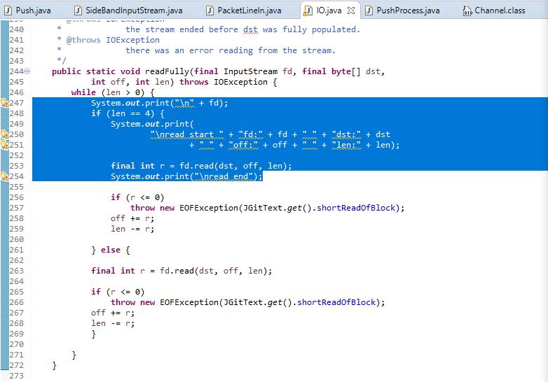

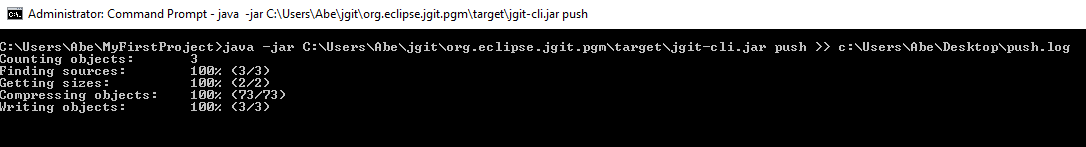

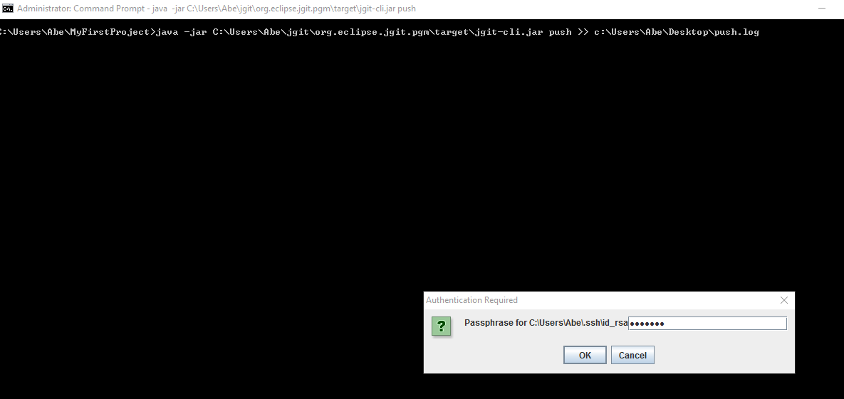

I tried the update, same timeout. Not sure if Egit is the issue. The issue may be in jgit?
I compiled jgit and get the same timeout issue.
I put in some sysouts in the code to try to pinpoint the issue.
