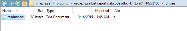

You didn't provide enough information to really know what might be going wrong, but since the sample report runs it may be as simple as adding the MySQL Driver to the location shown in the image. The instructions in the link you show above doesn't tell that you need to add the JDBC Jar file for the database you are trying to connect to.
index.php/fa/27436/0/
  • Attachment: Drivers.png
    (Size: 9.76KB, Downloaded 845 times)

Thank you for your reply, it gave me juste enought information to be able to progress and know exactly was is wrong, i just need to know how to do it.
1- I change my birt from 4.4.1 to 4.2.2, i was not able with 4.4.1 to found the directory to install the mysql Connector.
2- was then able to copy into WEB-INF/lib/ the mysql-connector-java-3.1.14-bin.jar
3- as I was testing I found out that you cannot access report file outside of webapp out of the box. the report I was trying to make was in /home/user/public_html/files/tmp/ and birt is in /home/tomcat/apache-tomcat-8.5.6/webapps/birt/
If i copy the report into birt/report/ it works fine. Now i will try and find how to allow birt to access /home/user/public_html/files/tmp/.
have any pointers on that?

Last thing I did to allow birt to access a external wa to create a symbolic link in birt as birt/reports tha was pointing to the folder where my website was dropping the reports.
whit this my birt is working fine.
