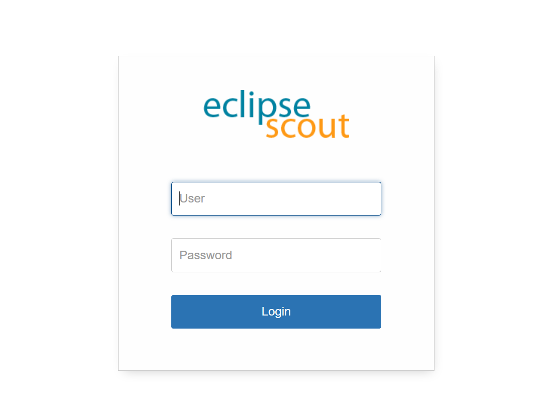

hi expert, it seems that everything is in order, but after make a deploy with tomcat, I can't run the app.

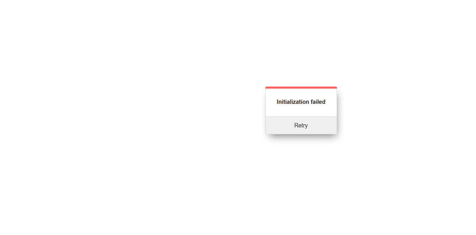

The loging frame is working fine, but after this step, i get
"Initialization filed"
error.
2016-10-22 13:19:03,834 ERROR [scout-thread-24] org.eclipse.scout.rt.client.clientnotification.ClientNotificationPoller - Error receiving client notifications - MDC[principal=notification-authenticator, jobName=ClientNotificationPoller]
org.eclipse.scout.rt.platform.exception.PlatformException: java.security.cert.CertificateException: No name matching localhost found [translator=org.eclipse.scout.rt.platform.exception.DefaultRuntimeExceptionTranslator, user=notification-authenticator, calling-thread=scout-thread-24, job=Tunneling service request [seq=1, submitter=ClientNotificationPoller]]
at org.eclipse.scout.rt.platform.exception.DefaultRuntimeExceptionTranslator.translateInternal(DefaultRuntimeExceptionTranslator.java:54)
[Updated on: Sat, 22 October 2016 13:58] by Moderator

Re: deploy app with tomcat, server error [message #1746135 is a reply to message #1746133] Sat, 22 October 2016 23:38 Go to previous message
ok this problem was solved Smile
I was adding the certified to a different location.
After make a correction everything run well.
Thank you guys!
