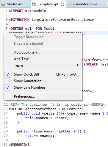

When I debugging my generator.mwe I can't stop in breakpoints inside .xpt templates because eclipse doesn't let me set it (view screenshot). However .java files work correctly.
Besides, when I debugging eclipse show error message "Source not found" but my project is configured in source lookup path.

Hello everyone,
Finally I got debug in xpand templates. I was trying put the breakpoint in a impossible location. About "Source not found" if you advance step by step the source sometimes doesn't appear, but in xpand templates works correctly.
