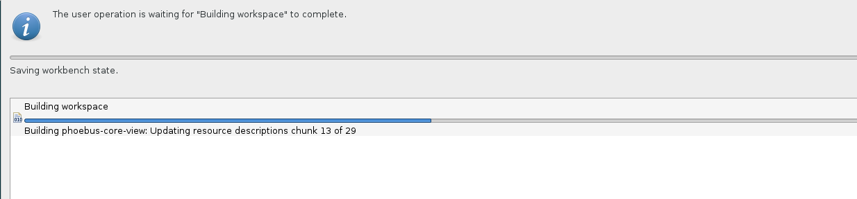

A file in the DSL I am working on gets variables and function declarations from
  1. Current file
  2. One file implicitly included by all
  3. Files explicitly included with #include
I use this fragment
    		fragment = scoping.ImportURIScopingFragment auto-inject {
    			ignoreCase = true
and provide a descendant of ImportUriGlobalScopeProvider and ImportUriResolver to handle the implicit import and #include statements respectively.
Variables are resolved properly but performance is quite bad. If I go to Project -> Clean, Eclipse runs in the background a long, CPU intensive process (see attached screenshot) and Eclipse becomes sluggish. My understanding is that this process constructs an index of some sort and scope provider is involved.
If I remove the scoping fragment, variables defined in included file fail to resolve, the process of building the index still goes on but for seconds instead of minutes.
I suspect that the index is useful only for namespace based variable resolution. How can I disable the index building processes and keep the scope provider for the file the user is editing?
  • Attachment: screen.png
    (Size: 14.94KB, Downloaded 117 times)

i doubt your assumtions on building the index is wrong. its not building the index (that would be writing resource descriptions) but it is updating resource descriptions which is resolving cross references and validation.

My resource description strategy ignores some resources to minimize the work of index building process.
I did not expect any difference in performance since I am still using my own global scope provider but strangely updating the index went from 95 seconds to 7. As far as I can tell variables are resolved correctly.
I don't know why these modifications improved performance. What tools do you use for monitoring XText plugins? JVM Monitor reports memory usage but nothing about CPU.
Re: Limit scope provider to few files [message #1745243 is a reply to message #1745242] Thu, 06 October 2016 15:48 Go to previous message
