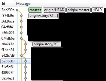

we have a strange state in one of our productive git-repositories when using egit/jgit.
When doing a fetch, the origin/master toggles between two commits (although, there were no changes). I attached screenshots of our history.
index.php/fa/27291/0/
index.php/fa/27292/0/
After merging some more commits to the master, we have the same behaviour, but with another commit. I didn't find a systematic schema until now. Unfortunatally I cannot reproduce it in a small example repository.
Can please anybody help me to analyze/understand the state and find a solution. Even asking questions to me would help me.

Sorry, I didn't recognize that there were answers. Thanks for your replies.
Today we solved the problem. In the central repository there was an additional branch(?) called HEAD (see screenshot). After deleting it, everything was solved.
We don't know, how this happened, but at least we know how to solve it in the future.
index.php/fa/27728/0/
