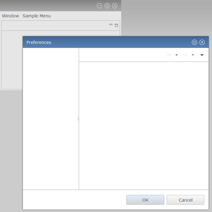

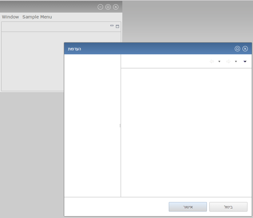

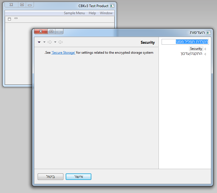

Hi all,
I'm build a basic application to test tycho build, and, RTL/multi-languages rendering in RAP 3.1.1 .
My dummy application is running on both RAP and RCP thanks to single sourcing.
While both RAP and RCP versions of my application are both rendering some widgets in hebrew (Yes/No, Ok/Cancel, preferences menu), only the RCP application is rendered in Right-To-Left.
Do I have something more to do in RAP to enable RTL?
Any help would be greatly appreciated.
Regards.

Re: RTL not working with RAP application [message #1744940 is a reply to message #1744936] Mon, 03 October 2016 03:45 Go to previous messageGo to next message
how did you enable the right-to-left support? Did you set the SWT.RIGHT_TO_LEFT style on your main Shell? Is this a workbench application?
Ivan
Re: RTL not working with RAP application [message #1744947 is a reply to message #1744940] Mon, 03 October 2016 04:36 Go to previous messageGo to next message
That's indeed a workbench application.
As suggested by you, I have added an explicit Style (SWT.RIGHT_TO_LEFT) for the workbench window configurer when locale is "hebrew" and it works Smile !!!
