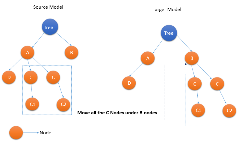

I am using ETL for transforming the source model to target model. Both source
model and target models are using the same Ecore model. I have attached the use
case in the image Eplison_ETL_UseCase.png. The use case is very simple.
I have to write the transformation rule to move the ("C" Nodes and its children
Nodes) of parent "A" Node to "B" Node.
I am finding difficultly to writing these rules for movement of containers between
the Nodes, Basically I am filter the Node "C" during transformation of Node "A".
Later during transformation of Parent Node "B" I am quering all the Nodes"C" and
adding its to children. I guess the guard : conditions is not allowing to add the Node
"C" to Node B. If I introduce the new separate rule to copy only Node "C" and its
children. Then Node"A" and Node "C" and it children disappears.

How about doing a copy transformation and then moving the C nodes under B in a post{} section of the transformation?

I did the movement in Post section and It works Smile
