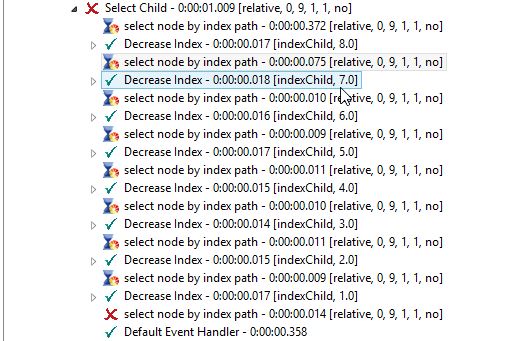

Re: Loop and event handler [message #1744793 is a reply to message #1744768] Fri, 30 September 2016 05:16 Go to previous messageGo to next message
I did what you explained, but it does not decrease my indexChild variable.
In my Select Node by index path I have set the indexChild variable
INDEXPATH : ${indexChild}
Weird?
Re: Loop and event handler [message #1744812 is a reply to message #1744793] Fri, 30 September 2016 08:21 Go to previous messageGo to next message
Finally I found this bug report
https://bugs.eclipse.org/bugs/show_bug.cgi?id=404446
But Now more complicated I would like to be able to manage a kind of recursive stuff.
To do a test case for all levels for one node in my tree.
If someone has a sample, it would be fine, because even with the event handler I am a bit blocked in my mind...
