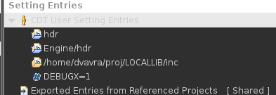

I've been doing some playing around. I have some test code where the macro is defined in the preprocessor entries dialog but Eclipse acts as though it isn't there. If I define it in a CDT parser block in the code it does see it. However not all macros need this.
It is defined as DEBUGX=1 in both Preprocessor... and Paths and Symbols.
It's not consistent.
