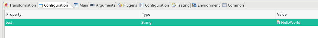

Set de value field in lauch configurations:
index.php/fa/27213/0/

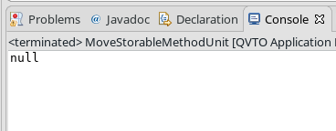

Log instruction and its result:
index.php/fa/27214/0/
index.php/fa/27215/0/
Thank you.

Re: Passing external variables from eclipse [message #1744425 is a reply to message #1744416] Mon, 26 September 2016 15:46 Go to previous messageGo to next message
Hi Daniel,
Daniel San Martín wrote on Mon, 26 September 2016 13:02
Hello Ed,
I cannot assign values to variables, according to your explanation. I am doing something wrong or this kind of feature just work in java because you mention to include an import directive.
Here some screenshot of what I did:
The screenshot with Console output clarifies that you use "QVTO Application Launch Delegate" to run the script.
This type of configuration is provided for the case when you simultaneously co-develop Java blackbox and Qvto script which makes calls to it.
For simple cases it's enough to use "Operational QVT Interpreter" to launch scripts.
I've tested both run configurations and it seems that "QVTO Application Launch Delegate" does not correctly pass initial values for configuration properties. I'll check this further.
Sergey.
Re: Passing external variables from eclipse [message #1744427 is a reply to message #1744425] Mon, 26 September 2016 16:05 Go to previous message
Sergey Boyko wrote on Mon, 26 September 2016 15:46
Hi Daniel,
Submitted https://bugs.eclipse.org/bugs/show_bug.cgi?id=502205
