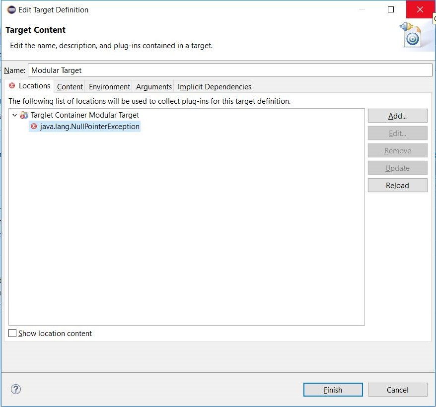

Ok. So after looking through a lot of files and preferences, I found this error message in the target definition. That can be seen from the uploaded image.
For some reason the target platform was pointing to a 'null' value... I have no idea how this has happened, and I had no error message telling me so.. I only found this by looking for it.. The issue was corrected by simply creating a new target file poiting to the software site that contains all my required plug-ins.
I hope someone else will find this information useful if they have a similar issue.
