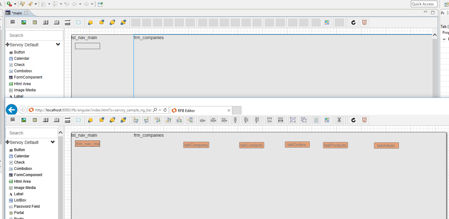

See the attached image:
index.php/fa/27168/0/
i open something inside my Eclipse browser (the top part) and the disabled icons are rendering completely different and we also miss the "orange" boxes down below (they are there see the section of the top left one)
The stupid thing is that when i debug my eclipse from eclipse (so i start one through eclipse to debug it) then it works like how it should..
So starting it for real in a real installer works differently then when just starting it up in debug mode.
Both are just IE, but in the once that works the user agent is:
Mozilla/5.0 (Windows NT 10.0; Win64; x64; Trident/7.0; rv:11.0) like Gecko
and the one that fails is:
Mozilla/5.0 (Windows NT 6.2; Win64; x64; Trident/7.0; rv:11.0) like Gecko
i am on windows 10 so it should not give 6.2 (which is i think windows 8.0

i don't think that is the problem. the user agent and the document.documentMode both report that it really uses 11
The only thing that is really different is somehow the Windows version i run on...
