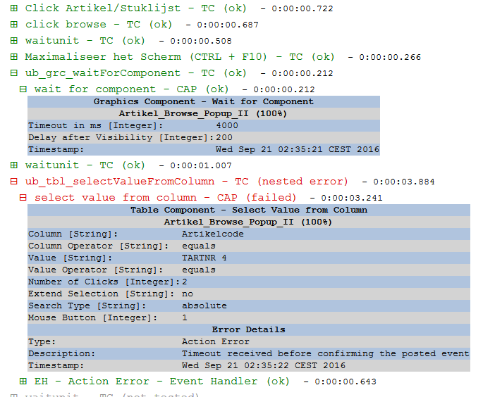

We are using Jubula for 3 and a half years. But i never have seen the action 'WaitForComponent' working.
You specity a timeout, let's say 4000 miliseconds,
and you specify a delay, let's say 200 miliseconds.
But the timeout is never used: the actual wait is only 200 miliseconds (the delay time). the system does not wait for the component as i expect.
So i always have to add a ub_app_wait action. This because of the timeout Action Error which often occurs and should be prevented by the waitForComponent.
Strangely enough, i find nothing about this on this forum.
Do you have an idea about what is going wrong?
I am currently using Jubula 8.2.2.055, but also in older versions i never have seen the waitForComponent working.
Jubula is running on Windows 7 Professional.
I will add a screenshot showing the problem.
Many thanks in advance!!
Jurjen

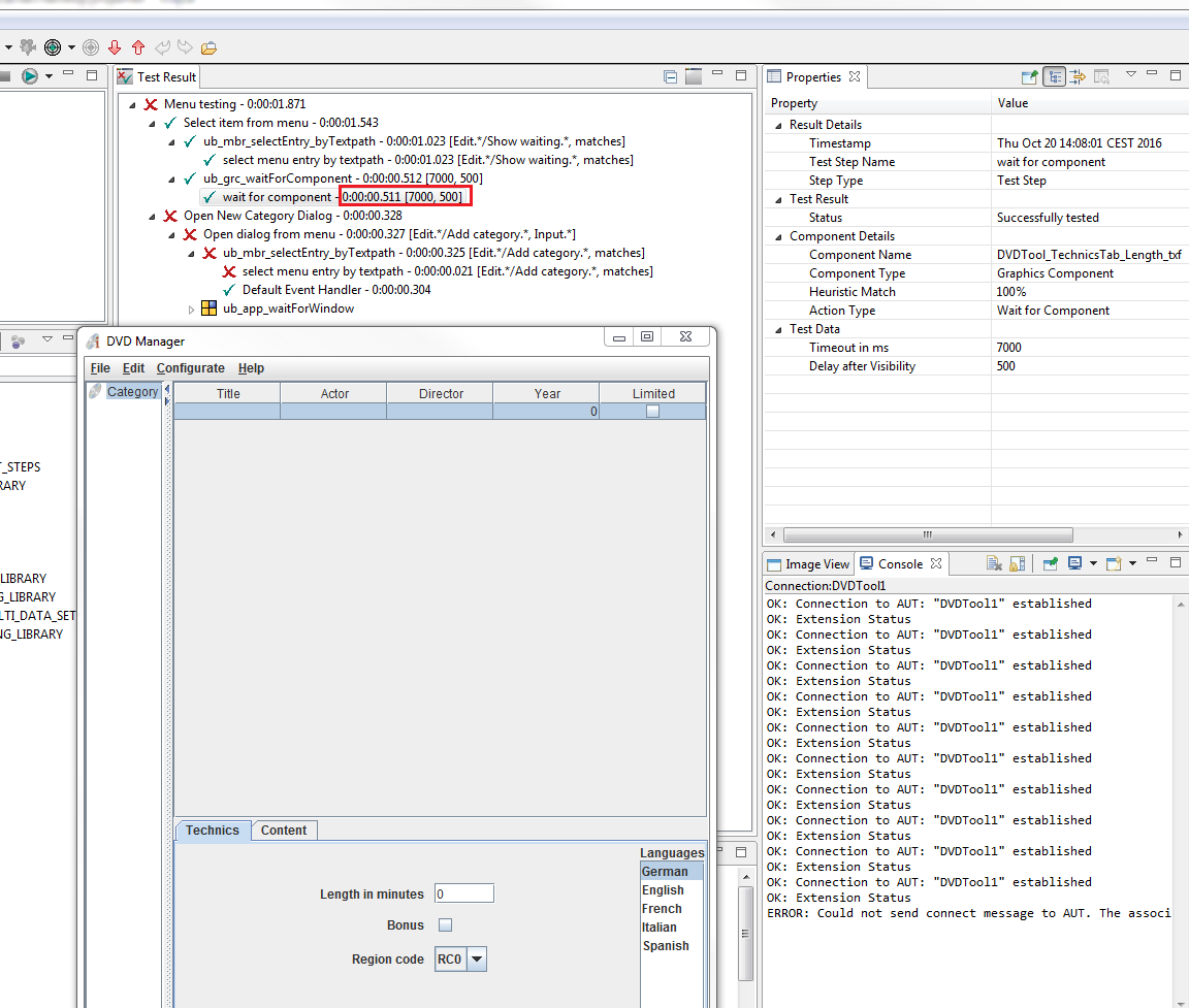

I tried the waitForComponent in the DVDTool sample, but there i also can't get it working. The waitforcomponent only waits for the specified delay. The specified timeout is ignored. I added a screenshot so that you can see what is going on. What am i doing wrong?

from the image it looks like you are waiting for the text component "length" in the tabbed pane - which is indeed visible. That would explain why the test continues immediately. The test appears to select from the edit menu (to show the waiting dialog), then to wait for this component. Since the component is on screen even when the dialog is present, the test passes.
Does that make sense?
