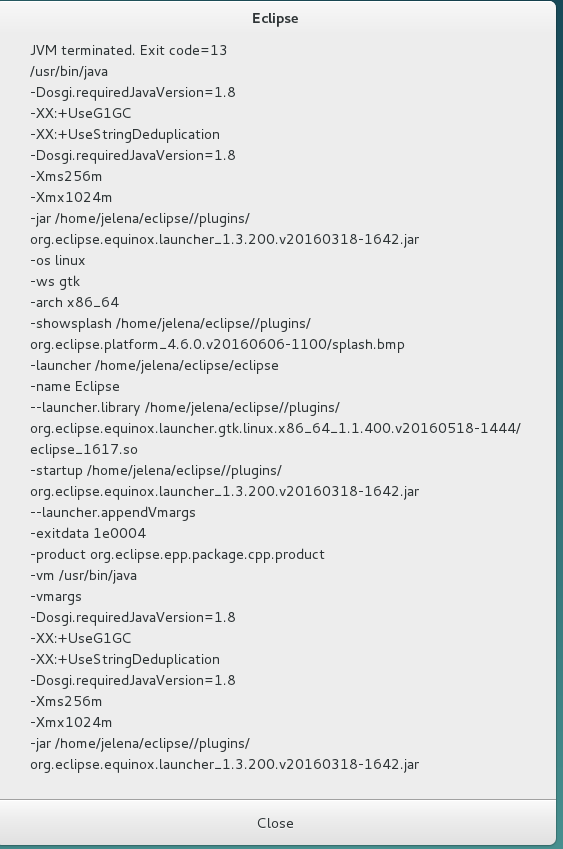

I have VM Linux Debian Jessie distribution. When I try to launch Eclipse there is a message:
Java HotSpot(TM) Client VM warning: You have loaded library /home/jelena/eclipse/plugins/org.eclipse.equinox.launcher.gtk.linux.x86_64_1.1.400.v20160518-1444/eclipse_1617.so which might have disabled stack guard. The VM will try to fix the stack guard now.
It's highly recommended that you fix the library with 'execstack -c <libfile>', or link it with '-z noexecstack'.
Gtk-Message: GtkDialog mapped without a transient parent. This is discouraged.
I trued with command:
sudo execstack c /jelena/eclipse/plugins/org.eclipse.equinox.launcher.gtk.linux.x86_64_1.1.400.v20160518-1444/eclipse_1617.so
But there is a message:
execstack: cannot open "c": No such file or directory
execstack: cannot open "/jelena/eclipse/plugins/org.eclipse.equinox.launcher.gtk.linux.x86_64_1.1.400.v20160518-1444/eclipse_1617.so": No such file or directory
I hope someone will have an idea what to do. Thanks.

Although I was convinced that I chose 64bit java and 64bit Eclipse, that was not the case. I had 32bit JRE. After proper instalation of 64bit JDK, and seting update-alternatives to 64bit JDK, there was not issue with Eclipse anymore. Everything is working properly.
