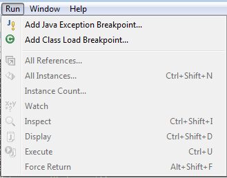

Hey Ed,
Yes, I'm aware of the perspective mechanism.
Selected is the "Java perspective". I also tried Modelling and Ecore perpective, and ATL. Allways the same run menu, as attached.
  • Attachment: run-menu.png
    (Size: 9.68KB, Downloaded 443 times)

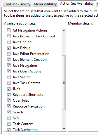

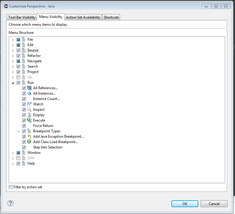

Open the Java perspective, select from main menu Window -> Perspective -> Customize Perspective, and check if Run menu and/or toolbar entry are disabled.
Re: Run configurations ?! [message #1743673 is a reply to message #1743672] Sun, 18 September 2016 14:29 Go to previous messageGo to next message
Yes, they are. But they have similar sub-categories as the ones in the Run menu.
Note that the "Run/Debug" option (together with a "/") only appears in the Shortcut tab.

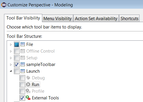

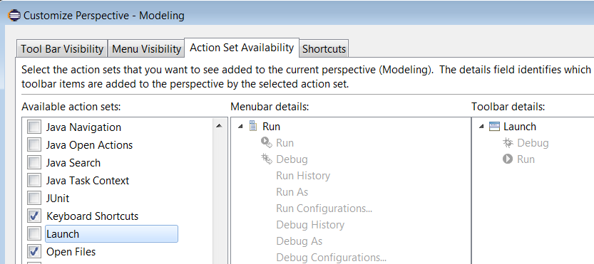

There is also interaction with the action sets, so for the Modeling perspective, opened with an empty new workspace, I see this:
index.php/fa/27115/0/
There are grayed out entries that I can enable with this part of the dialog:
index.php/fa/27116/0/
Is your problem different if you run your installation with a brand new empty workspace? Is there anything in the Error Log view that might indicate that some bundle is failing to start?

SVN subclipse seems involved again, but I'm not sure I undestand the report properly.
Attached is the visibility options' menu with the old workspace[/edit]
