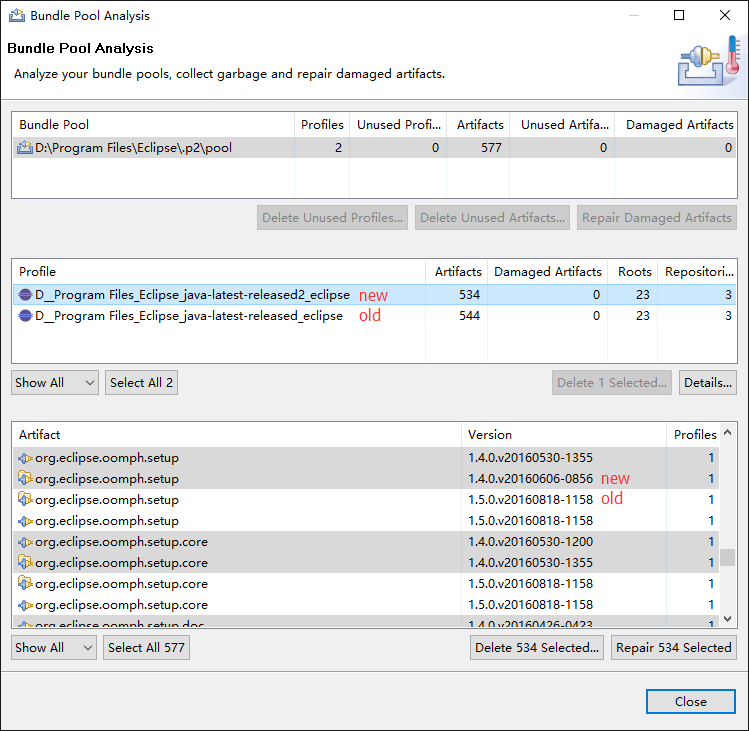

Found in the Bundle Pool Analysis, Oomph version is not 1.5 but 1.4

To what "Oomph version" exactly are you referring? Can you show a screenshot?

index.php/fa/27091/0/
Marked "new" is my new install of Eclipse, "old" is a previous install of Eclipse
Two versions of the Eclipse is 4.6
Before install Eclipse is used by default is 1.5, new install of Eclipse is used by default is 1.4
Why not continue to use 1.5?
Re: Why oomph plugins versions from 1.5 become 1.4? [message #1743503 is a reply to message #1743481] Fri, 16 September 2016 01:56 Go to previous messageGo to next message
We found the problem in our promotion system and we've fixed it. You should now see the 1.5 build as expected. Can you please try to update?

Issue has been solved
Thank you
