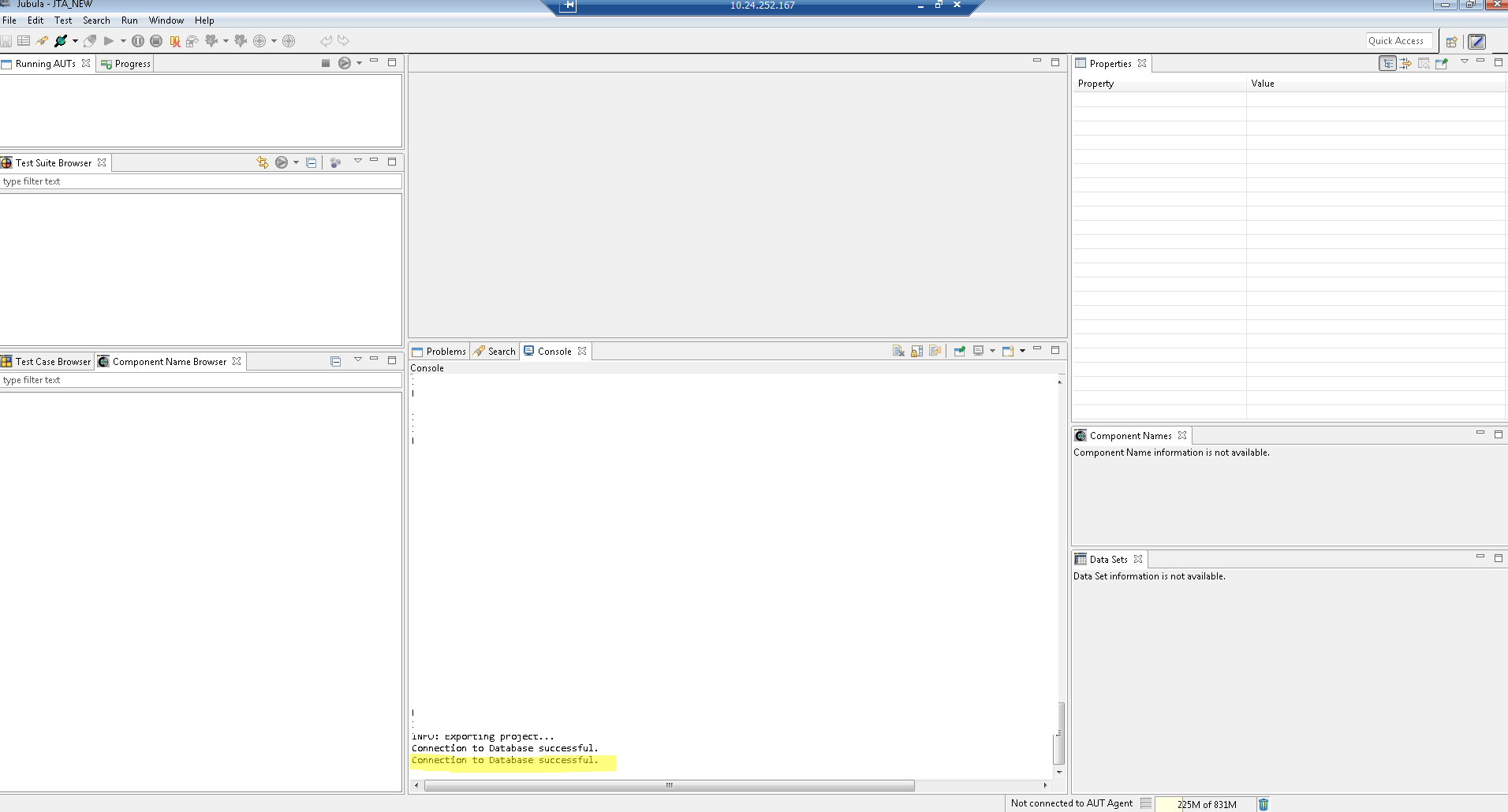

I created a new schema. Imported old projects to the new installation. Trying to test if everything works well I get the error. I have tried via testexec and directly from the ITE itself i get the same error. I attached the full client log to the post and also screen shot showing successful connection to the db.

Re: Jubula 8.3 - Database connection failed because of invalid or missing database detail [message #1743345 is a reply to message #1743334] Wed, 14 September 2016 09:53 Go to previous messageGo to next message
When does the error above come? Does it come when you try to open a project via Test->Open? Do you see an error in the ITE, or just in the log files?
Alex
Re: Jubula 8.3 - Database connection failed because of invalid or missing database detail [message #1743354 is a reply to message #1743345] Wed, 14 September 2016 10:15 Go to previous messageGo to next message
After speaking to a developer, it looks like the version of the ITE or testexec that you are using to connect to the new database is the *old* version (database version 50.0). So the database is correctly created, but the client you are using to connect is outdated. Can you check whether you're starting testexec / the ITE from the right installation? Bear in mind, if you have multiple machines, that the installation needs to be updated on all of them. The version of the ITE can be checked via Help / About.
Alex
icon14.gif  Re: Jubula 8.3 - Database connection failed because of invalid or missing database detail [message #1743365 is a reply to message #1743354] Wed, 14 September 2016 10:36 Go to previous messageGo to next message
Worked like a charm. I had to update my environment variable it was pointing to the old version.
