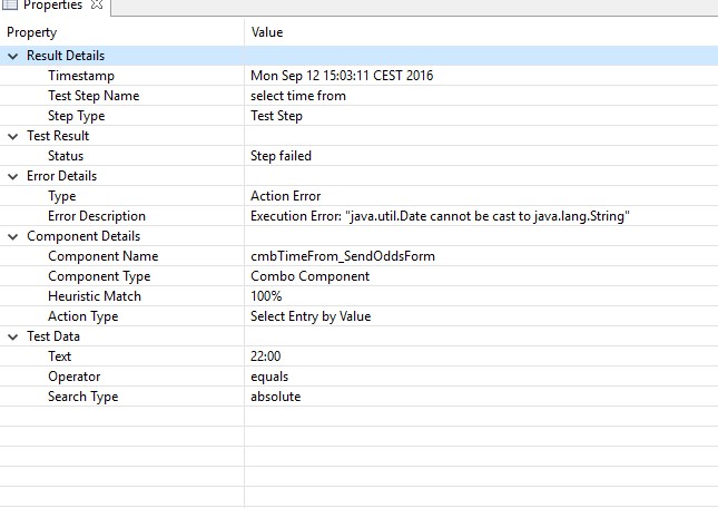

I have one problem with ,my test after upgrading to 8.3 version... I cannot use "Select entry by value" for my combo box component. I have two steps - one is to click in the component and the other one is to select the value from the same component. These steps are working in 8.0 version of Jubula. But now I get Execution Error: "java.util.Date cannot be cast to java.lang.String" for the second step. Does someone know how can I fix this error?

This is indeed already fixed. The fix is attached at the bug, you must simply replace the jar in the plugins folder in your installation.
https://bugs.eclipse.org/bugs/show_bug.cgi?id=500207
All new versions will include the fix, so this must only be done for this specific version

Now it works! Thank you very much!
