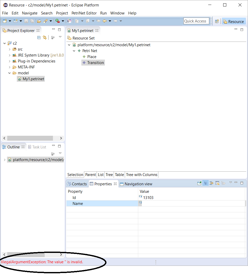

In my metamodel, the name is of String type.
I always see the "IllegalArgumentException" in the task bar, when I am in the property value box. I cannot name my objects at all.
I had same problem with the "ID" property, but then I changed the "ID-type" from String to Integer. Then it worked.
I do not know why I have this problem.
Please see the attached image.
Help me. Confused
  • Attachment: ecf.png
    (Size: 53.78KB, Downloaded 292 times)

which datatype did you pick for the "name"' property exactly ? You should probably pick EString (and not "String") or EInteger (and not "Integer") which are supposed to be in the proposals.
