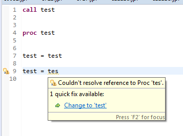

Re: xtext add cross reference in expression [message #1742760 is a reply to message #1742757] Wed, 07 September 2016 09:35 Go to previous messageGo to next message
My problem is I don't want to show warning if it not find cross reference in expression.
index.php/fa/26986/0/
  • Attachment: procref.png
    (Size: 5.98KB, Downloaded 326 times)
