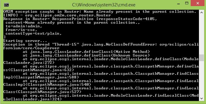

I'm trying the scenario with subscribe/notify in OM2M by using CoAP. I used the code below in the Monitor class of Actuator:
public void CoAPlistenter(){
System.out.println("Starting server...");
try
CoAPMonitor server = new CoAPMonitor();
server.addEndpoints();
server.start();
catch (SocketException e)
System.err.println("Failed to initialize server: " + e.getMessage());
return;
System.out.println("The server is listening on /monitor");
However, when I running the application, the NoClassDefFoundError appeard:
index.php/fa/26952/0/
Can Anyone know how to fix this problem? Thanks in advanced!
Trung
Re: Problems when Running CoAP monitor within a plug-in application [message #1742564 is a reply to message #1742303] Mon, 05 September 2016 08:43 Go to previous message
Francois AissaouiFriend
Messages: 38
Registered: April 2015
Member
Hi Trung,
It seems the class is not present in the current classloader of your bundle.
Try to import the package from the OSGi environment using import package attribute in the MANIFEST.MF file (if Californium is present as a bundle or exported by another plugin).
Otherwise, you can directly include the Californium library following this tutorial in your bundle.
Hope this can help.
