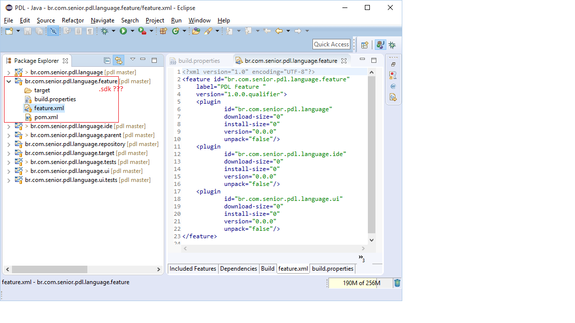

I created my DSL, I tested it with "Eclipse Application" and it works fine.

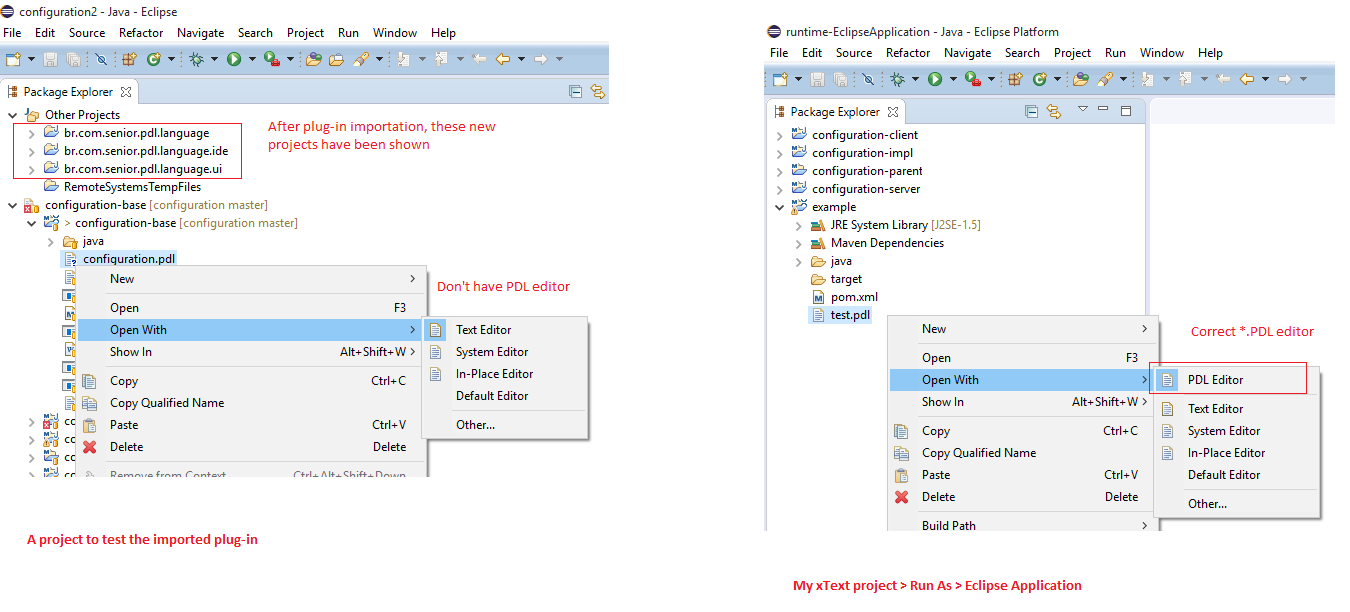

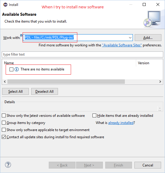

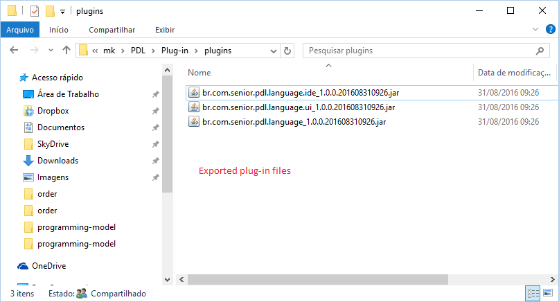

So I have exported my projects as a plug-in, selecting "Deployable plug-ins and fragments" as recomended on the forum and at the xtext documentation. But when I have imported then in a other Eclipse for some tests, they were imported. I created at a new project a new file with my DSL extension but nothing happened. In Eclipse > Installation Detais > Plug-ins it is not shown. If I try to install it through the Help > Install New Software and I point to the directory with the generated plug-in files, Eclipse shows "There are no items available".
Note: I don't have any project with sufix ".sdk" as some comment in some issues at the forum, instead I have a project ".feature".

Hi all,
Another very easy step to export your dsl plug-in is using Maven, e.g. open your prompt command (I'm using Windows) go to your parent xtext project directory and type mvn clean install. The plug-in artifacts are generated into the ...youdsl.repository/target/repository folder. The repository contents are your plug-in that should be installed in another Eclipse.
